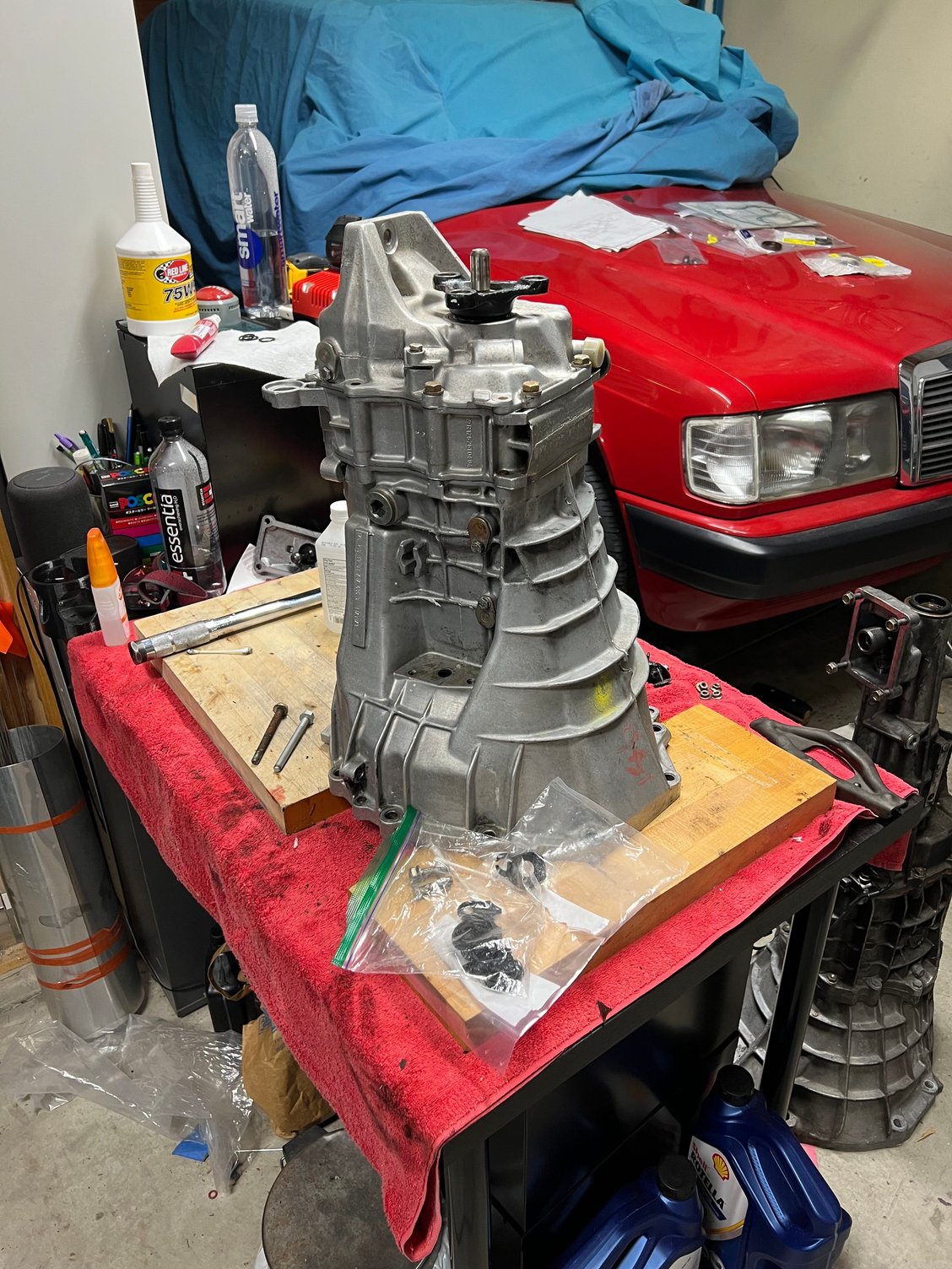

Mine had to to sit for 8 months because I had to pull my manual transmission to do some work on it including overhauling the clutch after 34years/200K miles of service.
In 4 months the fuel had already turned yellow and tarnish. The car would not even start with this bad fuel.
So I drained the tank and blew out all the fuel even from the FD with a compressor about 4 months ago.

Yesterday, the car had to go to Radwood so myself and son finished the job just hours before the car show an it started on first strike with new fuel.

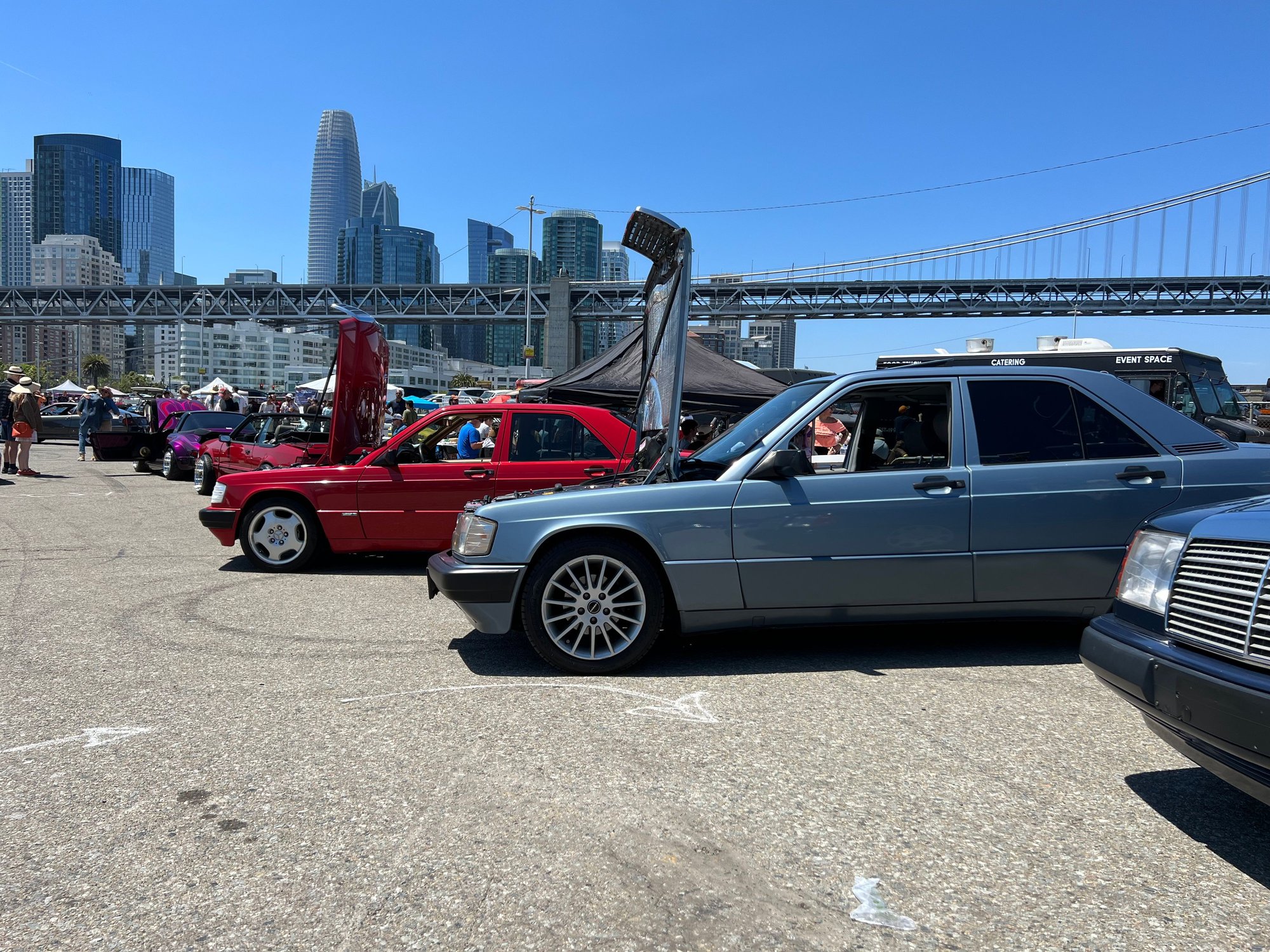

On the Radwood front it was good. People generally like my car because of the red color and manual transmission. I may take it to Legends of the Autobahn in August out in Monterey this year. It is always a great Venue. Here is a photo.
Tranmission out of the car, till hours before Radwood.
The Blue is 355's car, red is mine. Both original owners.

Haven't posted on here in a while, but I gotta give props to Dolucasi and his son for getting his car done and over to Radwood!
So many people didn't realize his car is a real factory 5-speed and not converted.

Our Blue and red go together very nicely in these shows. Now all we need is a white one to complete the color scheme.
What is sad and hilarious about that photo is that the purple Porshe in the background won the top prize in the show. However when she was leaving an hour or two after this photo was taken and we were all leaving her head gasket must have blown as there was smoke everywhere, it almost looked like the engine was on fire. They had put endless hours refurbishing the car. Sad, I hope they can get it all fixed up.
