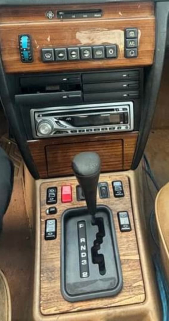

253K miles and no im okay with my current console, I want to black everything out on mine and don’t really care for the wood. Below is a picture of the console, I didn’t get a chance to see it today but if I can use most of what I’m looking for I’ll buy it.

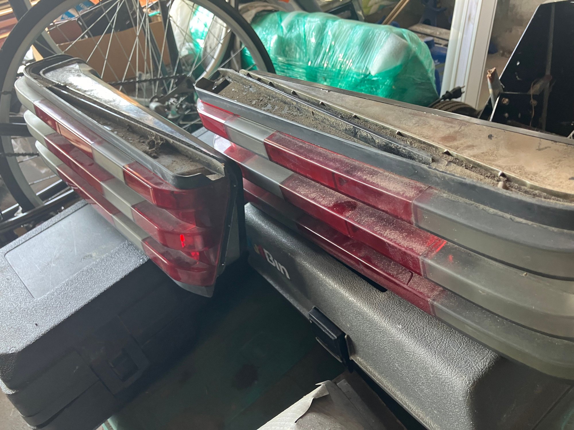

some other items I might take are the smoked tail lights and speakers but I mainly want the bumpers and skirts

Yes if you can keep the whole car and storage is free, it is worth the price. That center console in the picture looks to be in good shape.

Thank you both, after visiting I think the car is not worth the hassle. The bumpers have a few cracks and the interior was a bit too dirty for my comfort. I guess I will continue to be patient, keep my 87 stock for now and maybe get a mid year whose bumpers and other parts will transfer more easily. Main goal is to body color match front and rear bumpers and maybe I’ll just patch the rust and do the same to my rockers
it was not a total waste of time tho …aren’t these rare? I’ve only seen aftermarket remakes these seem original

You're welcome. Those taillights don't look original to me. I'm not aware of anything from MB where the taillights weren't solid red. I might be wrong but I don't ever remember seeing any like that. I'm afraid that you're SOL on the post facelift bumpers and body cladding fitting your pre-facelift car. The actual shape of the post facelift body was tweaked to the point that those particular parts are not compatible between all W201 model years.
