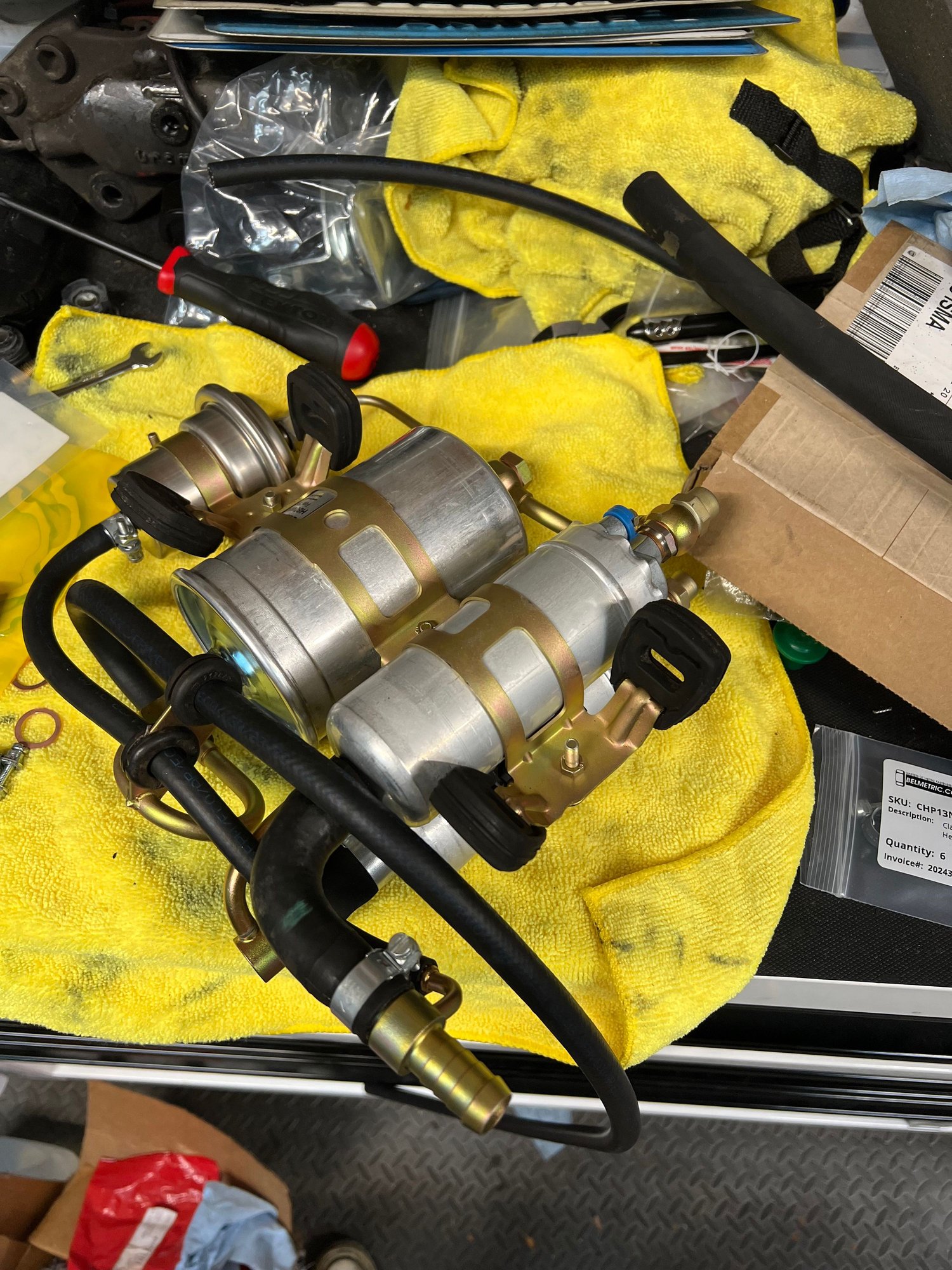

Fuel pump parts arrived back. I just realized I forgot to send one of the parts out for plating, not sure where the hell it ended up, so that's great.

I got new fuel lines cut and installed to the fuel pump assembly, with new hose clamps too. Preeeeetty

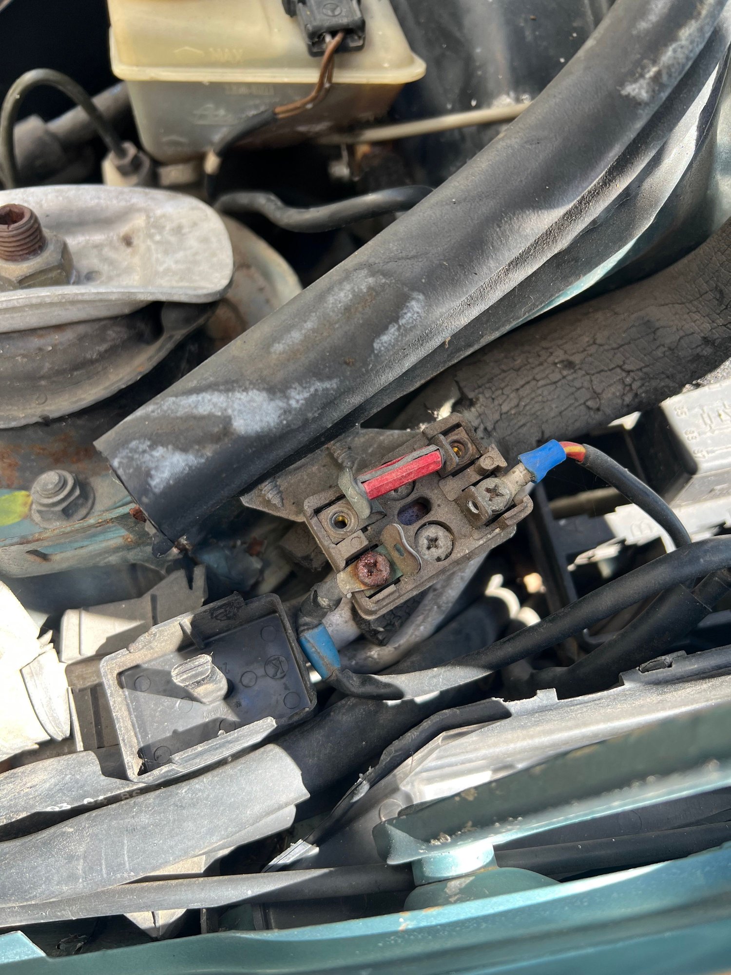

For now, a question about the extra fusebox with one fuse I do not know what it does, and what I have found to be the blower fan fuse. What amperage fuse is this supposed to be? It had an 8A in it, and it failed, after replacing it with another it melted the new fuse lol, whoops. I think it's supposed to be a 25A blue fuse but I'm not sure, and can't find anything online that says for absolute certainty...

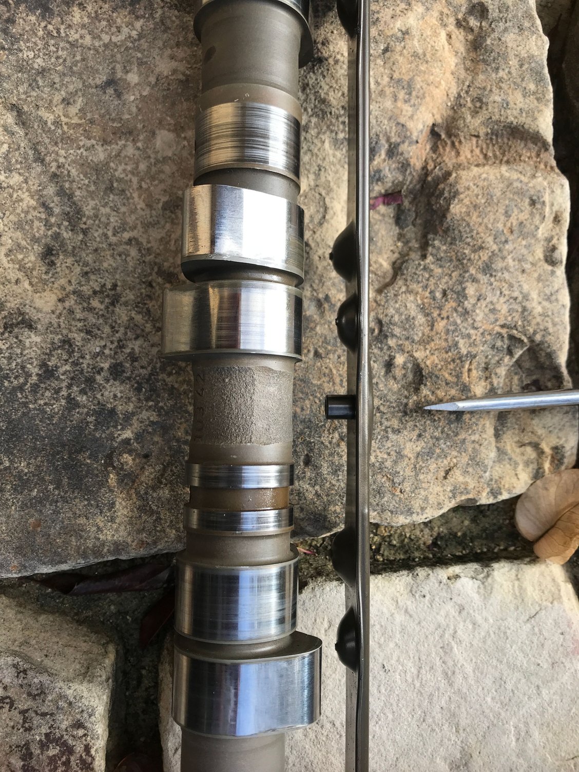

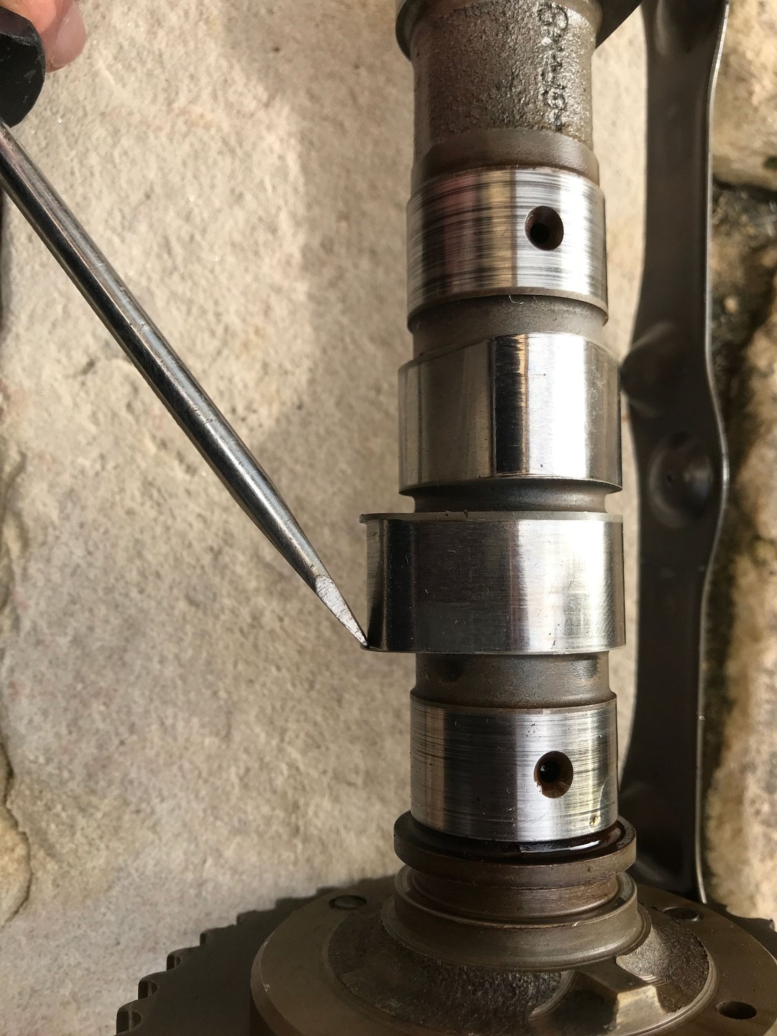

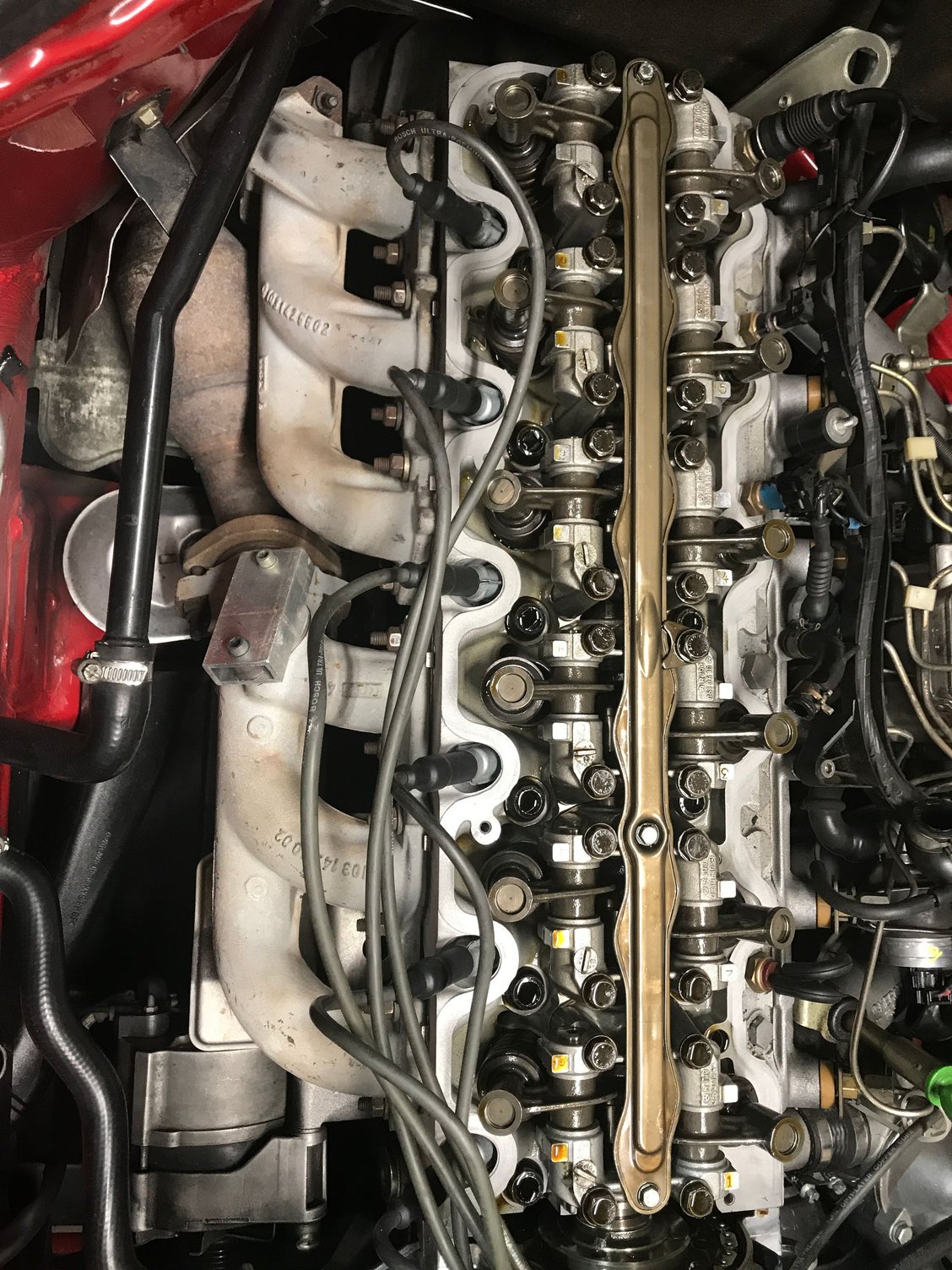

This is the camshaft, since somebody asked to see it, to maybe tell if it had the recall done?

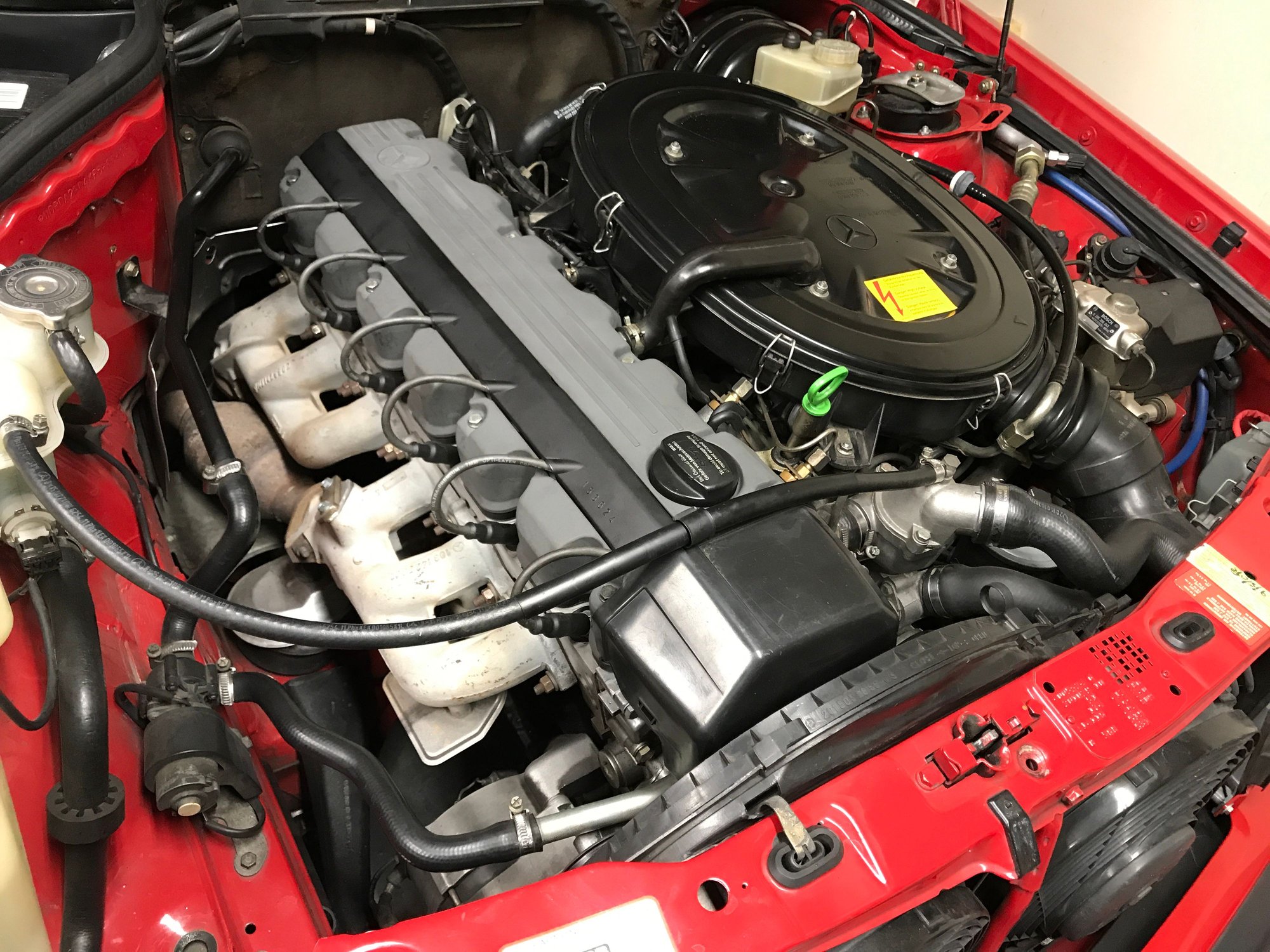

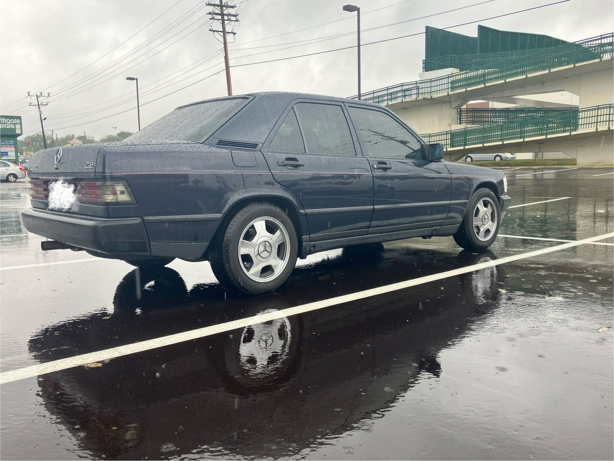

Welcome stitch2k1, I’m late to the party but have restored my 87 2.6 that sat 20yrs with the help of all of the ppl who have responded here, you will get the car sorted soon enough. That’s bracket i believe is just to hold the air box lid.
Here is a pic of my car, I just bought a dremel and will be tackling all my rust over winter. Places to check are the jack points, the inside of the bottom of the door trim, the battery tray, under hood drains and under the plastic buckets on each side of the trunk, all heavy water collection areas. My 2.6 has been the most reliable car I ever owned it took a bit to get it in a competent state but they are not hard to keep that way. I’m in Ohio

I was the one who asked for the camshaft adapter photo.
Sadly you have the old style camshaft not the updated one from '89.
Like I said, you need to check your cam/rocker wear before spending too much money on the rest of the car.
You may ending up having to spend the funds on the valve train replacement.
So you will need to remove the valve cover and the dripper and have a peak at the cam wear before too long.
If you are lucky, it is fine, if not you will need to source those items which will be 1000's of dollars, or you need to find a newer donor car in the JY.
I went the JY direction and for <$100 I had the entire valve train of the updated parts. Can't replace the head with a newer head but you can replace the valve train.
I don't think it has any significant camshaft wear, since it would be running funny, and it pulls strong all the way to redline. Perfectly smooth. If it needs a valve train or anything major I am going to put a 3.0 M103 into it, or an M104.98 instead of fixing the 2.6.

The fuse issue isn't one of current, it's that I don't know what the correct fuse is. I took a gamble for now and a 25A fuse seems correct. The fuse box does not list what amperage those fuses are supposed to be, nor does the owners manual (fantastic).

If you are willing to swap in another engine then do not worry about it.
Just so you know you may not notice a worn cam/rocker until it is too late. Mine was worn 1.5mm on cam and about the same on the rocker. So a total of 3mm loss and I stumbled into it trying to change the valve seals. I never noticed as the engine was running great, it even passed smog test in CA with the worn cam.
Again, yours might be just fine like my second car which is an '88 with the same CAM. But when you replace the valve cover seal at least make sure the dripper was updated to the later design.
It is an easy improvement. If it has a V washer to hold it down in the middle or some drippers just have a bolt holding it down that's good. If not you should buy the V-washer from a dealer. This improvement was made and the customers were not alarmed to it if the car was serviced at a dealer. Mine got the improvement at 60K miles. I guess it was a bit late.
Do you have pictures of the difference in the dripper rails?
Originally Posted by 190Efan
You can check with the MB Classic Center to see if they have the parts that you're having trouble finding. The can also tell you the paint code for the plastic clading on your car. That paint code will be different than the paint code for the body of your car which they can also tell you. I found this out from personal experience.
I sent them an email about 4 weeks ago, and never got a reply.
Old Dec 1, 2024 | 04:15 PM
  #41
dolucasi's Avatar
Joined: Mar 2016
Posts: 1,369
Likes: 195
From: SF Bay Area, CA
190E 2.6L 1989, 190E 2.6L 1988, BMW 535dXdrive 2014, BMW 428i 2015
Yes I do. The dealership has the V washer and new drippers. Always best to change the dripper too since the old one might be dirty and not its best.
One of the pictures show a new dripper and a new V washer I put in. The oil comes in the pipe under the bubble in the middle. What happens is under high oil pressure if one does not have the V-washer or that second bolt holding it down the dripper bends and leaks at the joint at the bubble. That causes the pressure in the dripper to drop and the cam lobes at the two ends are starved for oil. I am also including the cam wear for your viewing pleasure.
Happy motoring!
This is where the oil comes in
This dripper only has the V washer in the middle
This dripper only has the V washer in the middle and this type dripper does not have the provision for that second bolt. I believe they used these in 90-91. These are OK too.
This one has both a V-washer and a bolt towards cylinder one.
This one is my final one that has all new dripper and V washer. I bought these at the dealership 5 years ago or so.
This one is my final one that has all new dripper and V washer. I bought these at the dealership 5 years ago or so when the head was pulled off for a valve job. Shiny and new...
And my worn cam.
And my worn cam. Not pretty....
Happy motoring!
Gotcha, I will have my valve cover off sometime soon anyway since I have my bead blasting cabinet operational again, after some upgrades. Ironically specifically for blasting magnesium 16 valve 944 parts (valve covers, cam gear covers, intake manifolds) and my BMW V8 valve covers (M62TU, but also M62 and M60).

One word of caution. Be super careful sandblasting the M103 valve covers. My original got ruined by I powder coating company who claimed they are experts.
I warned them it is Magnesium not Aluminum, and yet they blew holes in the cover. The grey epoxy finish under the black metal is super strong. So people try to get that off sandblasting and that is futile.
It needs to be removed chemically with a super strong solvent and that is no fun. Instead I opted for removing the peeling black paint off and leaving the grey epoxy on there. Looks OEM to me.
This was a cover I found in a junk yard and I just peeled of the black paint with a blade. This was many years ago, still looks about the same.
And no mess, just patience....
Original cover with black paint peeled off
I have experience with magnesium from being an aircraft mechanic.
The dark gray is the color of oxidized magnesium. It will turn to an aluminum looking finish when blasted. I am skeptical that Mercedes put some kind of a primer on it that doesn't corrode and come off while the paint does. I think you are mistaking the magnesium oxidization for primer.
As for holes, if there is mag corrosion present, assuming you strip and blast it properly, the damage you find to the metal was already there. Pitting, worming, etc. You can't stop that from happening.
I've been working on trying to perfect a method to restore my very corrosion susceptible mag parts on my Porsche. I plan to experiment with ways to fill in the pitting to make them look "new" again.
Sounds like you know what you are doing. That is not oxidation, it is some sort of a primer that has a super strong bond to magnesium. Oxidized magnesium turns white from what I've read. This is dark grey.
Nope, oxidized mag is dark gray. White is corrosion particles, it's like aluminum corrosion where it turns to dust.
I also read that Magnesium is somewhat porous to oil meaning oil can penetrate it. Which is probably why they chose to prime it prior to applying paint.
I find it best to just leave it on there because it looks good and does not come off.
Yes it's a very pourous metal that absorbs everything. A good corrosion pre treatment is necessary before applying an epoxy primer, and then paint only on the outside where necessary.
