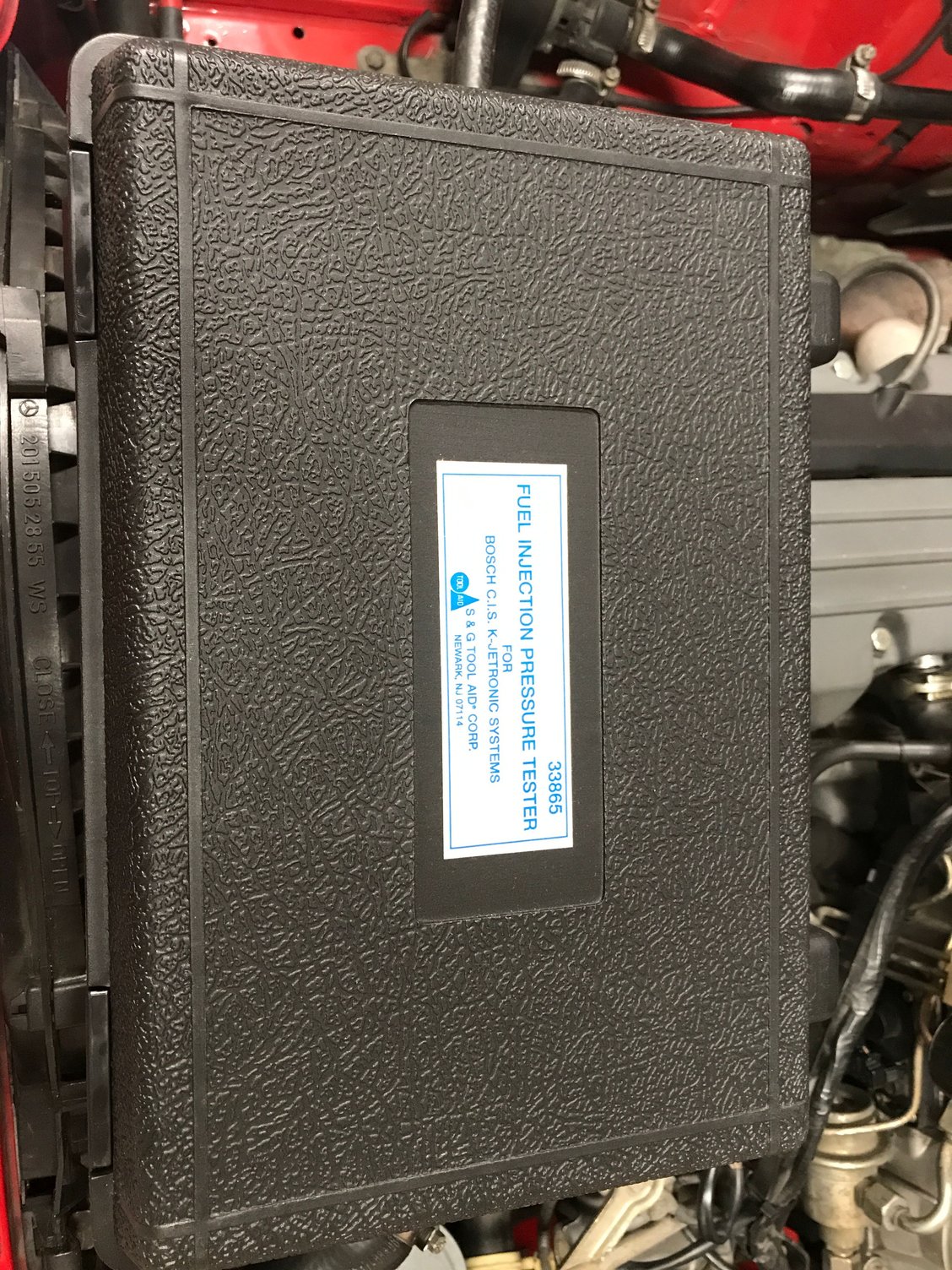

I need to order a fuel pressure gauge kit that works with the KE jet on the M103 (and later, KE jet M104 I intend to swap in this car), is there any Amazon specials that work or is the basic or deluxe kit that Kent (Mercedes Source) sells the only thing that works? I am in general suspicious of a ruptured diaphragm or a clogged filter in the thing. I bought seals a while ago, I just need to rebuild the fuel dizzy.

190E 2.6L 1989, 190E 2.6L 1988, BMW 535dXdrive 2014, BMW 428i 2015
I can vouch for this one. Works well and the fittings are correct. Anything else may turn into experimentation. Not sure what Kent is selling these days.
I have this one too and it works flawlessly.

The new spark plugs from Mercedes are Beru 14K-9DUO. They did not make a difference, still crank no starting on me.
It seems like I am only getting fuel from 3 of the 6 cylinders or something. When I took everything off that was the case.
The filter basket on the fuel inlet was still intact and not clogged.
I have seals for the distributor, so I think it is time to rip it apart and fix it.
I have one of these being overnighted (only $23.9 for overnight shipping) from Summit Racing. I got them to price match and save me a whopping five dollars lol.
