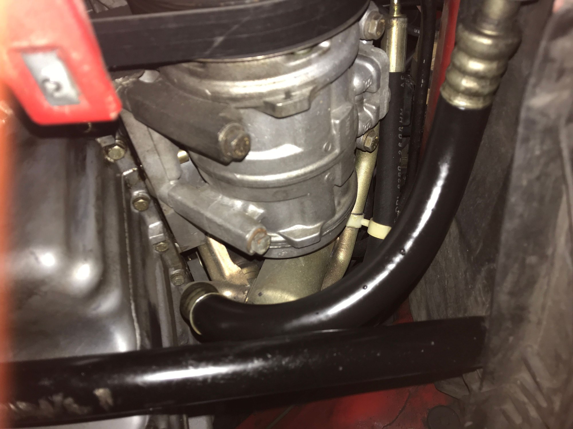

I do not have a 2.3 but it appear on a 2.6 you need access from the bottom to remove these 2 bottom bolts. There is also that return pipe bolted to the block that can only be reached from below. Not sure if the 2.3 also has that and if that needs to come out.
Hopefully you only need bottom access because the top is super crowded with PS pump, water pump etc.
Here is a view of the 2.6 AC with the bolts in the bottom. Oddly I have a 2.3 Haynes manual but it does not have much detail on removal of the compressor.
