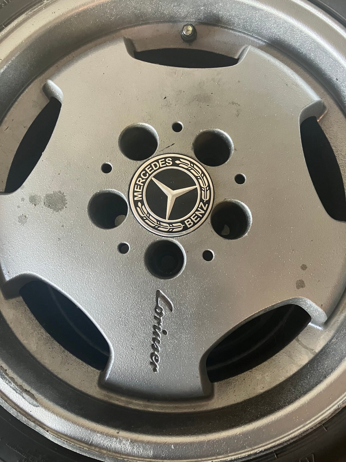

unrelated but happy to share that I will be restoring these 16 inch lorinsers for my car, still sitting on the fender spacers and need to get one of the wheels unbent. I think I want to paint them the body color of my car or should I leave them alone?

As for the wheels, that is a personal taste. I have something similar (but MB ones from a 1997 E420) and they look very good on my impala brown in original silver.
It actually adds to the look. I am not a fan of black rims but tastes differ. I will post a picture when I return from my trip if you like.

Helllll no, leave those Lorinsers alone, scratches and all. I like the original paint job.

Thanks dolucasi for the summary on how to do that safest. and yes please share! I will fit the wheels on the car and see how they are before anything it will take a while to get the bent wheel back from the shop.

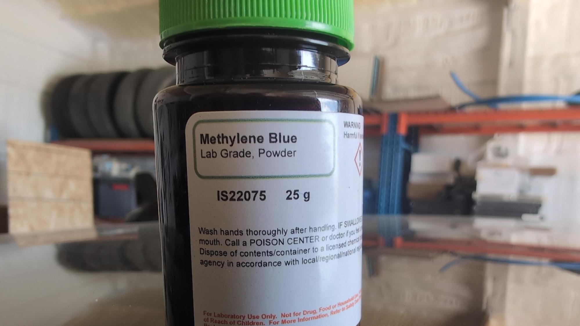

Don't blame you for being cautious. Chances are, there are a lot of things being done you've never heard of.
Methylene blue (C₁₆H₁₈ClN₃S) powder, have been using it for years, even before the feds realized ATE was selling blue brake fluid and put the kibosh on that. It doesn't take much, 1/4 of a teaspoon per qt will give you a nice blue color fluid. I don't recommend the liquid version of methylene blue, because then you are introducing potentially harmful ingredients, like... you know, water.
Agreed, you wouldn't normally be introducing air via a "dry" power bleeder. That's not how fluid dynamics work. But as you said, you can potentially introduce air into the system if you bleed too much fluid and the level goes too low. I have two identical brake bleeders, one for brake fluid and one for other fluids like differential oils. Brake bleeders are relatively inexpensive nowadays.

Will the methylene blue powder stain the interior of the fluid reservoir?
Old Aug 13, 2025 | 03:40 PM
Sathinas's Avatar
Joined: May 2010
Posts: 1,209
Likes: 188
S65
Never noticed staining of the reservoir. But to be fair, I never looked, either.
