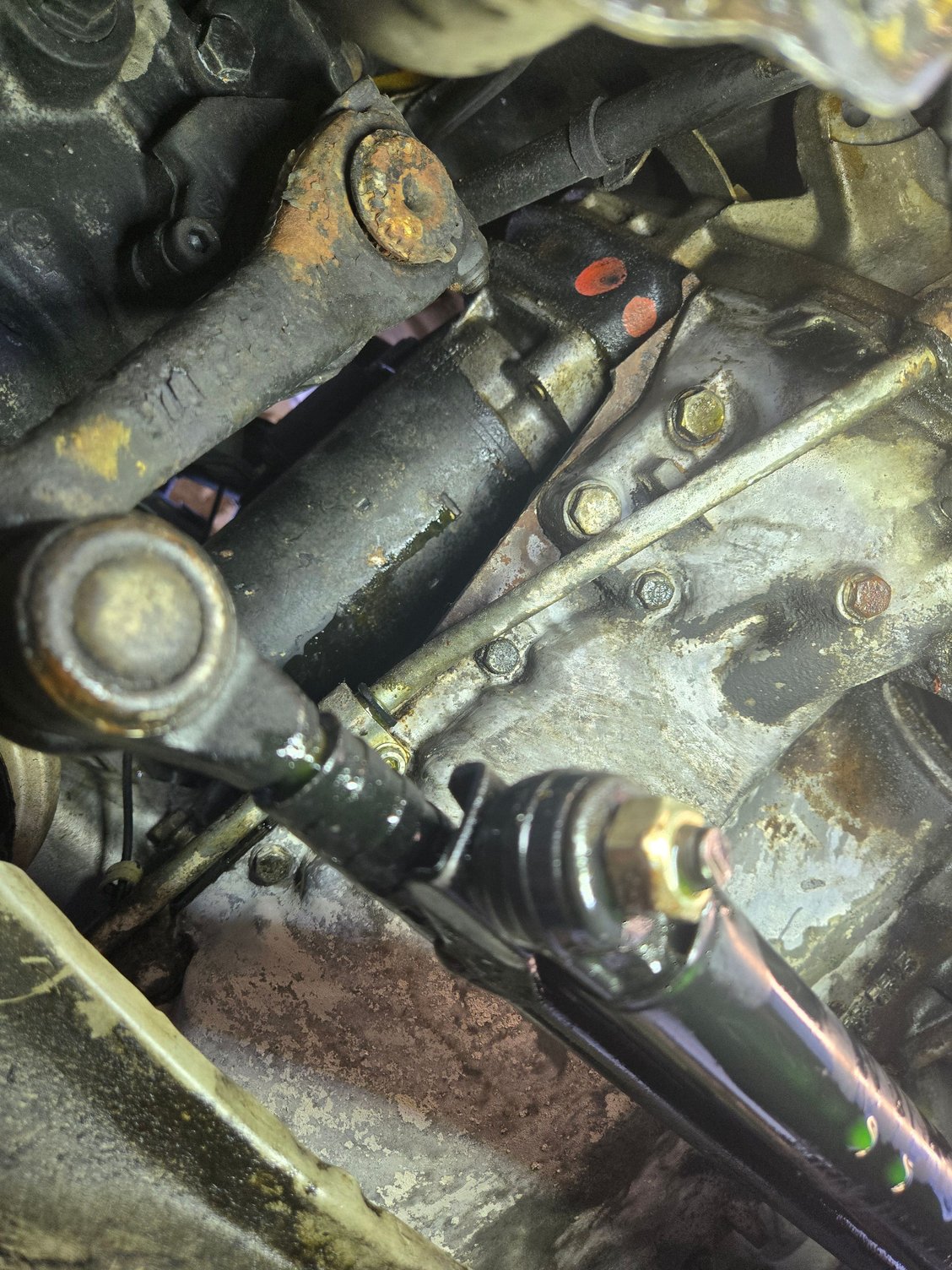

1989 190E 2.6
From what I can see, its originating from the intake side of the engine bay. It's leaking all the way down to the bottom of my engine supports and inner sway bars. There was a very slight pool underneath the port that the heater hose connects to, the one on the head very close to the firewall on the intake side. I tightened that hose clamp and the coolant light still came on. The highest point aside from that is on what I believe to be the starter (see first pic, its in the middle of the photo slightly to the left). I have also attached a general picture of the bottom of my engine bay to see if anyone can gleam anything from that. Its difficult to tell as it seems it only seems to start leaking when I'm driving, typically the coolant light comes on after about 15-20 minutes of driving. If I'm lucky.

190e 2.3-16
as far back is the wetness is its a high chance its heater core related. it was stated a hose on the intake side of the heater core related was tightened and possibly still leaks its obviously time to change the hose. my logic would dictate that if the easiest hoses weren't changed theres a good chance its time to change out all the cooling system hoses at minimum of piece of mind. possibly also coolant level sender, waterpump, and clutchfan just to not stress out over overheating in traffic.
i still recommend pressure testing before hand as it will physically expose leaks (do not over pressurize keep it normal operating psi). depending on the kit you buy/use it may come with adapters to fit your cap for the expansion tank to verify operation as dulcasi has said.
i highly recommend you check out mercedessource on his site or youtube as the guy has explanations more geared toward diy enthusiasts. it also helps to look online at parts diagrams to get a clue as what the repair could entail or what it even should look like on your car. always best to physically remove parts prior to purchase to compare with what the parts place can get. if you want to do it right also look for a physical factory service manual, free pdf, or get subscription to specific car repair info from places like identifix, mitchell1, alldata, etc. if your just a guy whos mildly curious and wants to pay shops to fix all these could partially even be beneficial as to know what expect from the job. (but please don't be that guy who asks for torque wrench calibration certs or has crazy expectations)
