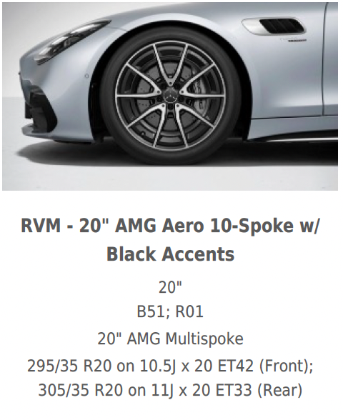

Tire size inconsistencies for AMG GT55 20" wheels
While exploring the available A/S and Winter tires for the AMG GT55, I discovered a discrepancy between published tire sizes for the 20" wheels. Unfortunately, I believe Tirerack blindly copied the MB "typos" and listed the incorrect 20" tire sizes in its online catalog. I opened a chat session with Tirerack customer service where it was agreed that a 1" difference in the outer diameter between the 20" and 21" tires was very odd. Tirerack has not corrected the sizes and I suspect that is because they are relying upon the tires sizes published in the MBUSA specifications.
Hopefully, a forum member with the RTM - 20" AMG Aero Twin 10-Spoke wheels can confirm the correct tire sizes.
2025 AMG GT Order Guide
Tirerack screen capture.
MBUSA 20
MBUSA 20" tire specs.

There are three choices for the 20" staggered 10.5"/11.0" AMG GT wheels - RTM, RVM, and RVN. The Order Guide shows 295/30-R20 and 305/30-R20 tires for the RTM wheels and 295/35-R20 and 305/35-R20 tires for the RVM and RVN wheels. All of the tire sizes shown in the Order Guide (including the 19" tires) have a nominal outer diameter of 28", except for the tire sizes for the RTM wheels which have a nominal diameter of 27". The chances of this being correct are near zero. I wonder how many tires will have to be returned to Tirerack before they correct the listing. Sadly, the incorrect 20" tire sizes (295/30-R20 & 305/30-R20) have attractive choices for A/S tires.

I have a 2024 AMG GT 55...with the RVM 20inch AMG multi-spoke wheels...they came with Hancock Ventus s1 evo z tires (295/35/20 front and 305/35/20 rear tires)

And...I noticed as well...TireRack/Discount Tire had the wrong tire sizes listed (30 profile instead of 35 with the 20 inch wheels).
I just swapped the Hankook's out for Michelin Pilot Sport All Season 4 (295/35/20 front, 305/35/20 rear)....they ride a little bit better (and should last a LOT longer)....

I think Tirerack is getting the wrong tire sizes from the Order Guide or some other MB documentation. I reported this to TR months ago, but I think they are too stubborn to change it. Once they ship enough of the wrong tires and have to eat the return shipping cost they will probably fix the website listing.
