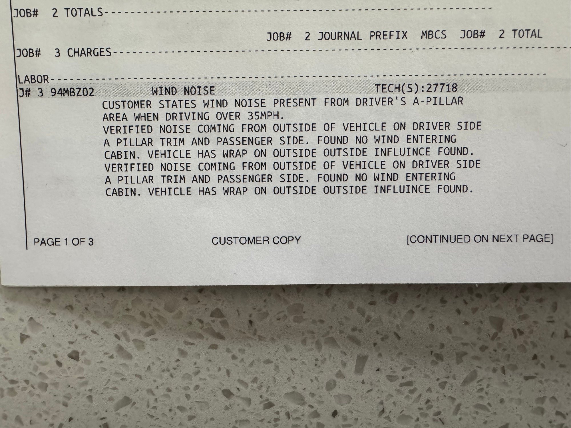

Old Mar 28, 2025 | 06:49 PM
Jordywilson's Avatar
Joined: Feb 2025
Posts: 21
Update on this: I took the car in, mentioned the wind noise, and gave them the TSB in this thread saying that it could potentially be a very related issue, and this was their response… they apparently did thorough testing of taping off mirror housings, door trim, etc to test if wind was entering the vehicle, and they found that it wasn’t. I’m also confused about the last line; it seems like they’re saying the PPF I have on the car has influence on the wind noise I’m hearing, which doesn’t make sense.
So if anyone else has this issue and ends up finding the cause, please pass it onto me. Would love to get it addressed eventually.
Old Mar 28, 2025 | 07:31 PM
W205C43PFL's Avatar
Posts: 32,333
Likes: 6,312
They are clearly not willing to help, try a different dealership.

I think I have this issue as well, from the Driver's side A Pillar, it seems more so on the Driver's Side Mirror side of the A Pillar, more noise than there should be at modest speeds. I also notice it from about 35 mph plus.
The above dealer blaming it on the PPF? What a joke. Is this what I will be up against with MB Service? (This is my first MB, was previously mostly Porsche and BMW.)
