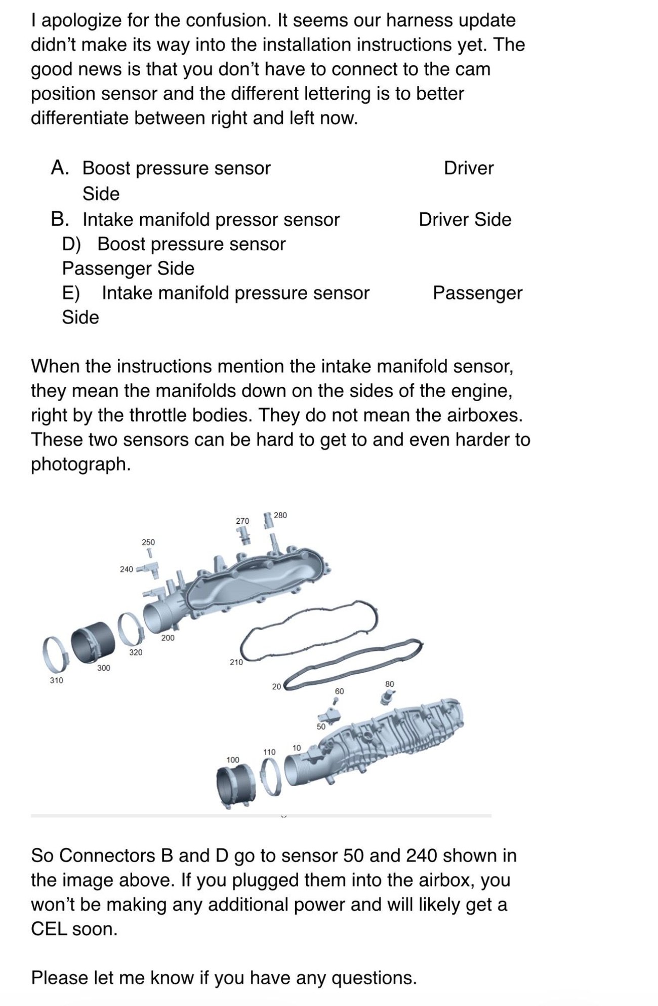

I only had 4 sensors it got tapped into.
2x on each side. 1x on each charge cooler, and 1x on each air intake box. Hopefully I didn't miss anything LOL, but I dont believe there was any other plugs I missed ?!

Strange...please check again. I had 5 inputs for mine. The 5th being any one of the 4 Cam Position Sensors. Maybe they took that out...?

There was a total of 8 plugs on the Renntech harness unit (not including the large plug for the RPM module itself). the 8 plugs plug into 4 sensors on the car.
2 female ends on each side of the car, and 2 male ends on each side of the car. basically disconnect the car wiring harness from its associated sensor. then plug the renntech harness into each open end you have now.
Mine looks just like the photo in the manual you posted. 8 plugs, plus the bypass plug/module.
I definitely would have noticed a random plug/wire hanging with no where to plug into. I know the instructions talk about plug "C" for cam position, but mine didnt have that at all. No C plug.
I did email renntech to confirm. But I drove the car, no lights, everything seems to be operating properly.

This is what renntech just sent me. And now I need to go back to verify I did it correctly. I would think if I didn’t do it right I would know by now. But maybe not.

ok @Vic55 ive got it PROPERLY installed now... and I can report.... its absolutely noticeable.
I had 2 of the sensors on right, 2 incorrect, it didnt throw a CEL, and it actually did feel faster then, but now? its a big difference. Maybe was placebo, or maybe it was just running well lol, idk. def not placebo now.
