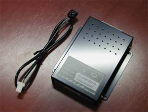

Hi, Richard , Cone , and others.
As I was busy and out of country ,
I could not have a chance to try Andy's hardware and
Richard's Linux software , though they were ready .
Anyway last week I was in Tokyo and got some information
about how to remove the TV interlocks of Mercedes Benz.
One company called INSPIRE TECHNOLOGY introduced
a kit which can remove the interlocks of recent MB models .
Price is 59,800 Yen (plus sales tax : see the picture) . Another kit for the old models is less than 30,000 Yen.
http://www.yellows-p.co.jp/newitem/tvkit.html -- Japanese
http://www.aoyama-pitin.co.jp/navi/navi.html -- Japanese
http://www.wintel.co.jp/vcs_2/parts/...ge/index2.html
----Japanese and some English
---- You can see modified COMAND
Type Japanese navigation

This shows actual parts of the Kit.
