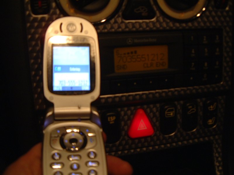

V300
>when you come out with the bluetooth model, where are we >suppose to mount the button to sync the phone with the car? >Also, do you have any pictures of the system working with >different phones?
I finally built a cable that works for all the P2K and Nextels.
Here are pictures of the V300 hooked up:
sorry about the quality. It was dark, and my camara is old.

That's awesome! I want that for my car NOW! I want to use a motorola v600 or v525 with it. Any testing done on those phones? Also, what about the antenna part of it. THe cable you show is just data. Do the cradles have to be built still so they can accomidate the antenna part?

Here is a picture of the cable.
This used to be a P2K serial cable. The kind that has the level converter on the DB9 side. What I did is, I opened the Motorola connector and switched the pins, so that they would meet the MB specs (this was real precision work !!!). Then I cut off the DB9 connector and crimped on the RJ45. Yes its only an 8 pin, so the recharging does not work, but its good enough for now for testing.
I am currently talking to a company that custom builds cell phone cables. I will have them build cables that are laid out like this one, but have a coil cord, and the antenna plug also. Maybe I will come up with an adjustable rubber piece for the antenna plug, so that it is easier to accomodate for the different cell pone types.
I would love to have individual cradles, but I don't have the means to build them. If anyone has ideas about that, please contact me.
