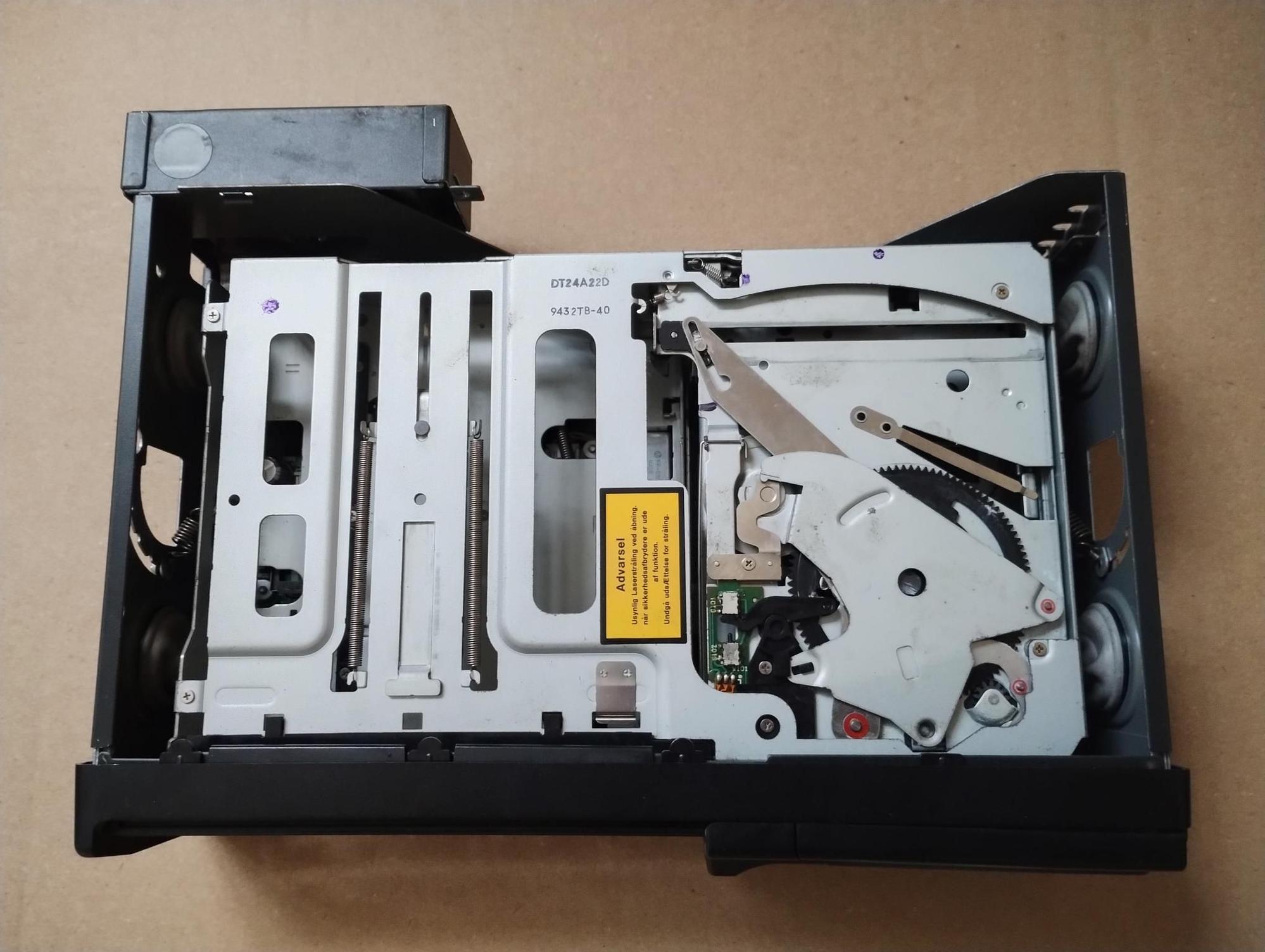

I get the same error on a 1999 CLK430. With the case off, I can see the CDs are loading OK. It could be a dirty lens - if so, does anyone have instructions of how to get at it to clean it?

See note #8...open the changer, and vacuum carefully, this should help, and wipe with micro towel, re-insert disc and should work.

Thanks for the reply and help. I've vacuumed the box, which doesn't fix it yet. Do I need to take more apart than just the case, as I've done so far - please see photo?

I never had to go this far, but at some point you might have to bit the bullet and source another changer i.e ebay, or even craiglist. GL
