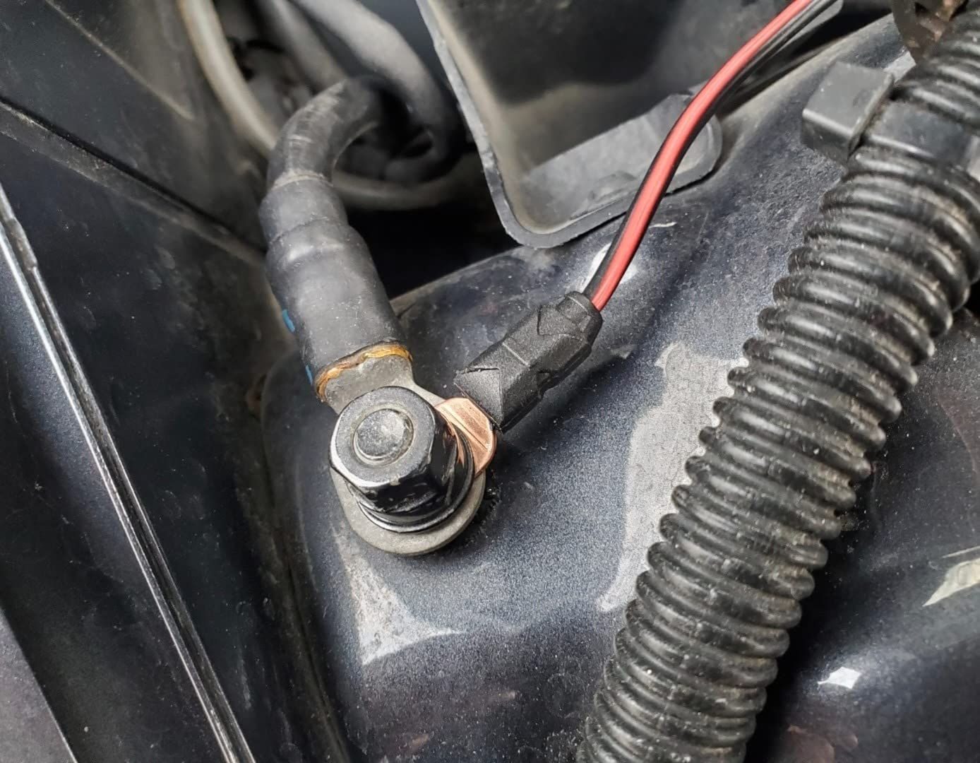

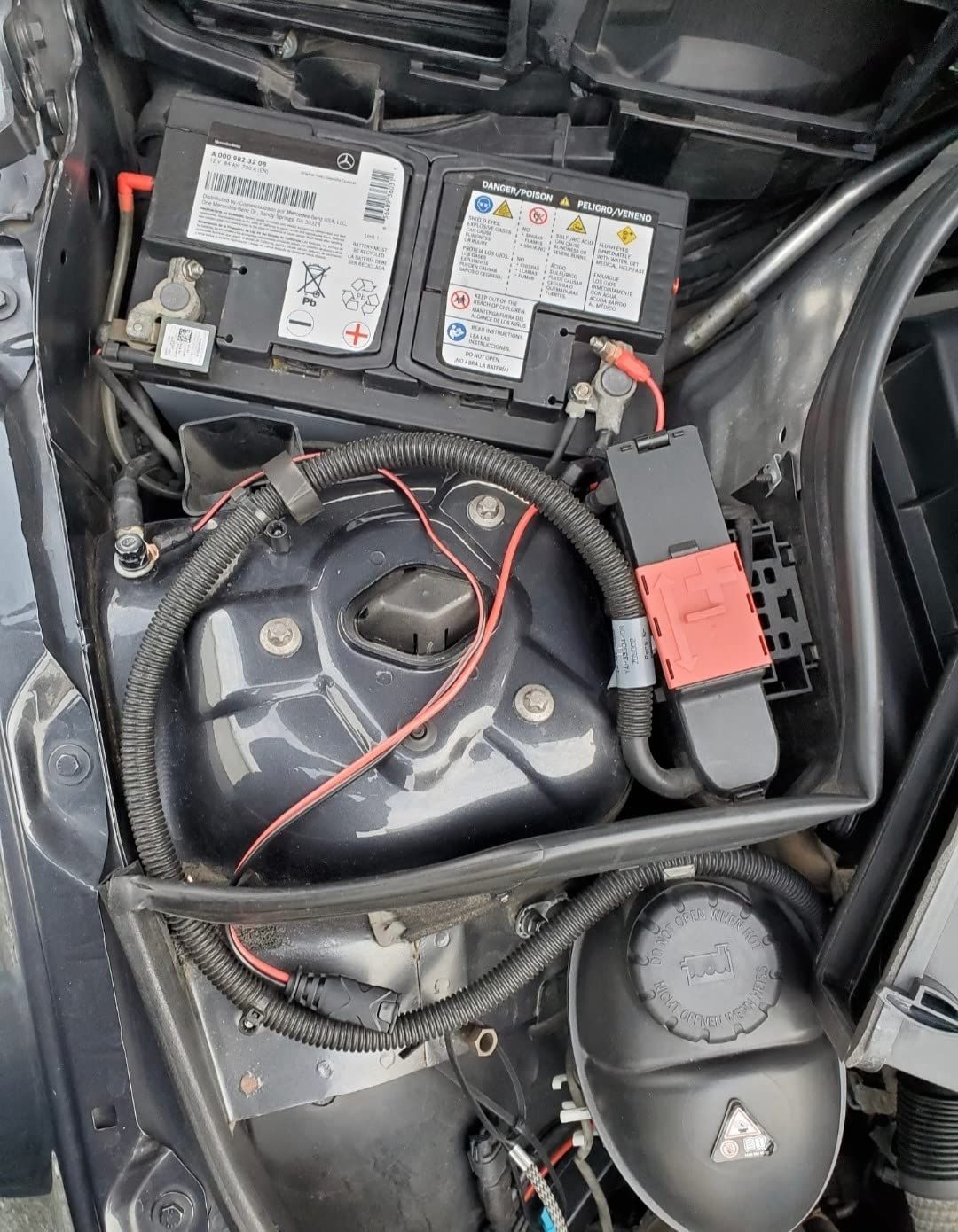

I dont put alot of miles on my W204 so I like to hook up my Noco Genuis5 charger to it once a week to keep the battery charged. I dont trust leaving the charger out, for weather reasons especially in winter and i dont trust my neighbors.
I installed the harness, positive directly to the battery, ground to the same ground post as the battery negative cable, then just put the charger in the engine bay when charging. I am able to fish the extension cord thru the front grill so i can close the hood and lock the car.

Your engine bay looks so clean!

I never had a battery charger before and got the Noco based on price and the positive reviews. I originally bought the Genius1 which did work except it took way too long. I had to leave it hooked up over night which I wasnt comfortable with. Also the Genius1 has the clamps attached, theres no harness to unhook. I got the Genius5 which take around 3hrs to do its thing. Its a pain to use the clamps having to remove the air box above the battery so i hard wired the harness using the eyelets. i read its better to not connect directly to the batteries ground so that's why I hooked it to where the negative battery cable attaches to the engine bay. the eyelet wasnt large enough to fit on the stud so I used a half round file to enlarge the hole. For some reason the nut on the positive battery post wouldnt fully unscrew so I modified the positive eyelet basically cutting it into a spade type connector to slide it under the nut.
Put some wire loom on the wires so it blends in and dont even notice it.
Then I bought another set of the clamps so I can use it on other batteries. The Noco has a special connector so I bought there adapter to hook to sae type connectors if ever needed. I actually bought everything on Amazon used, I look for the "Used-Like New" listings and saved alot.
