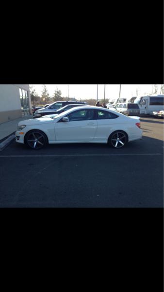

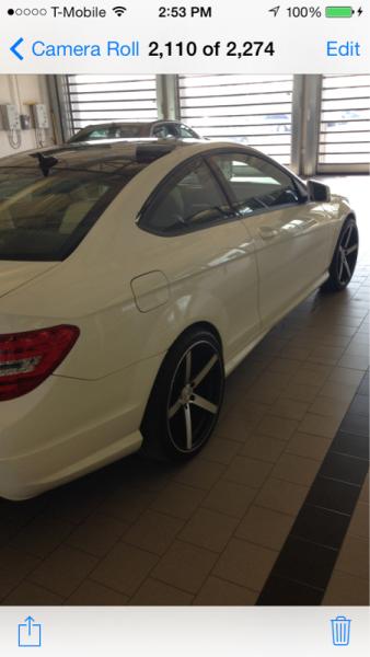

Am running 235 35 19 and 265 30 19 these tires fit the gap between the fender so well that the car looks like its lowered
The first picture shows how much the 40 offset sticks out in the rear so a 35 offset will stick out even more it's going to mess up the alignment of ur car.
Now am lowered on h&r SSS An rolled fenders
