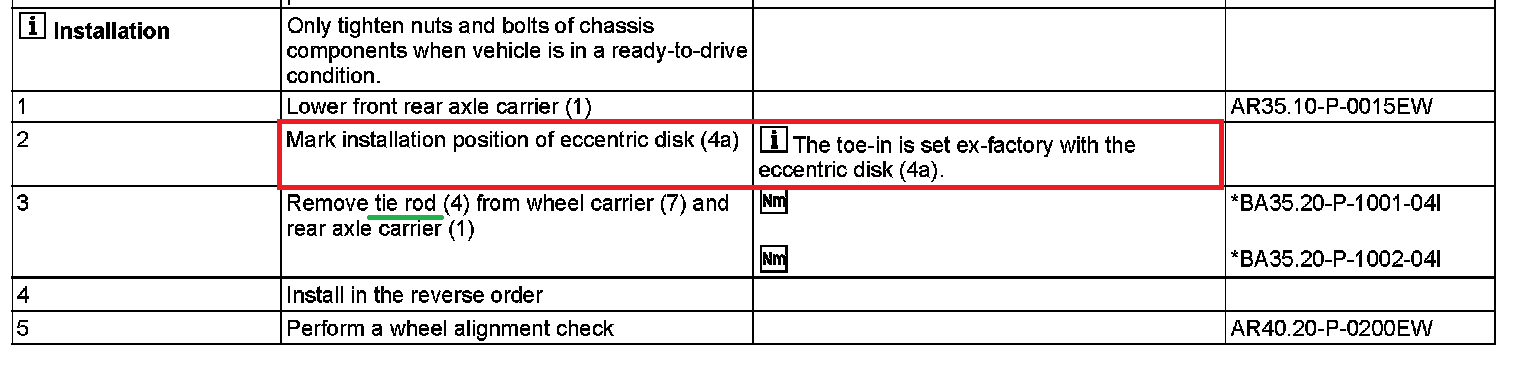

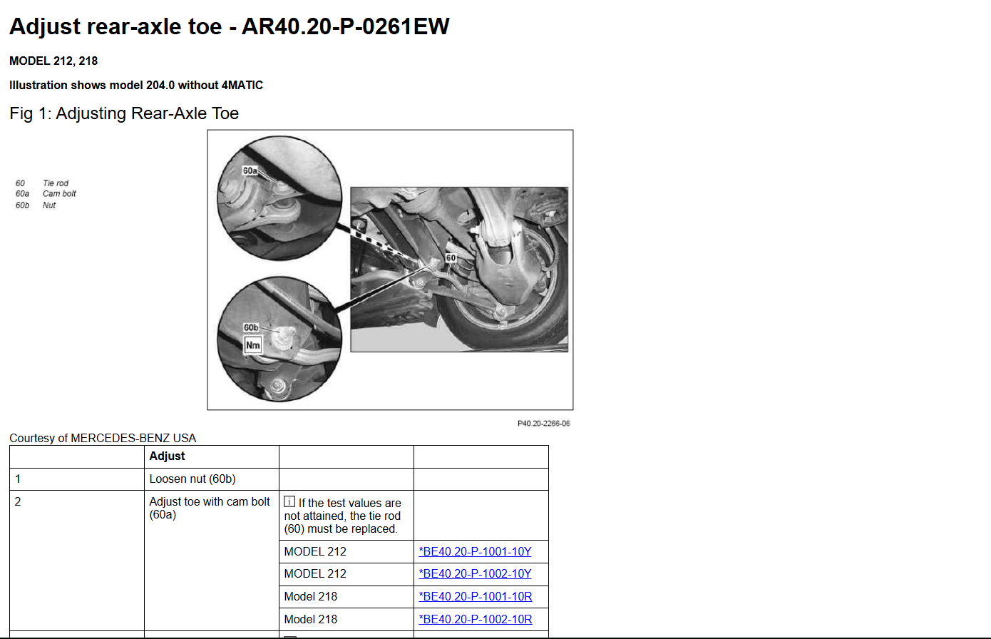

Rear- only toe is adjustable, to an extent. It uses an eccentric bolt and disc at the inside mounting point. When replacing the rear tie rod it is important to mark its position and install the new one the same way.
