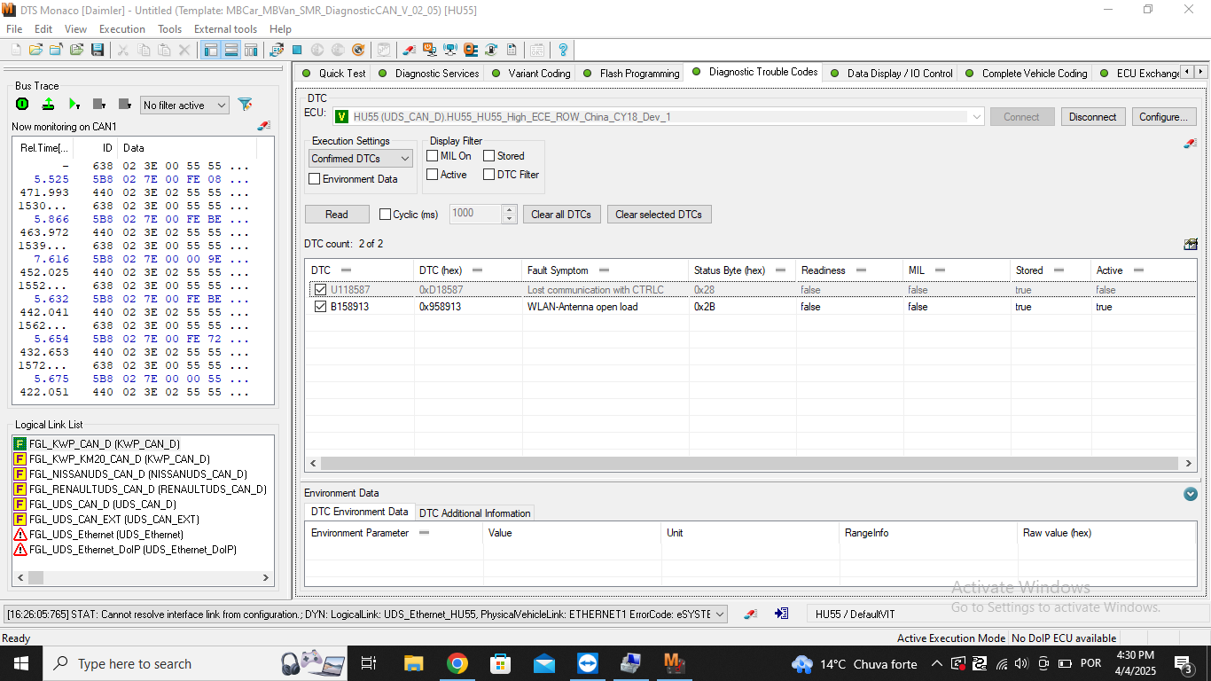

i have a NTG 5.5 COMAND in my c220d, and sometimes restarts while driving, how i can fix it ?
i have this 2 errors, can be of that ?

CTRLC is the Rotary/Touchpad panel from Central Console. This has On/Off button and it's also a Gateway for your Comand.
that i know, but the lost of communication can cause the restarting ?

Yes,
