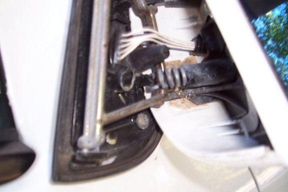

mine broke on the pass side, i drilled a hole where the hook used to be and put an "eye bolt" with a nut and washer in the hole. then hooked the spring to that, worked great.
i added a picture, its real bad because its raining right now, try to get a better one later.

i jus had the spring hooked to another part
