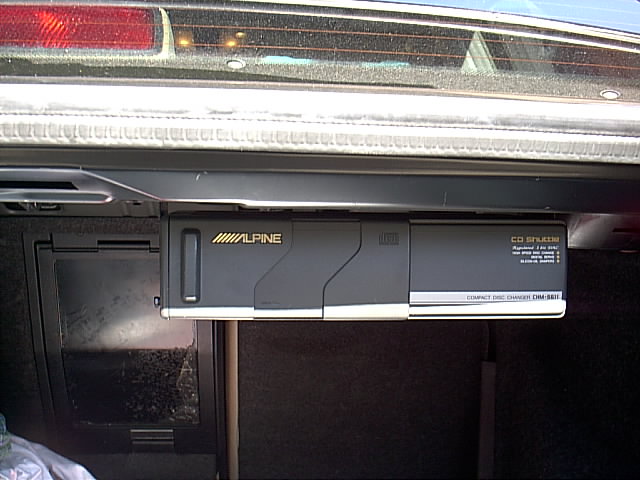

Question Can someone post a pic of their CD changer's installation position?
I just received a changer and can't determine how and where it's installed.
It looks like close to the battery since the fiber and power cables are there
but I can't find a spot to mount it. Maybe I need a kit or something. BTW:
It's going in a 2000 C280. Thx.

dont have a pic, but it should be mounted behind the rear wheel well of the passengers side. should be a little cubby hole to mount it.

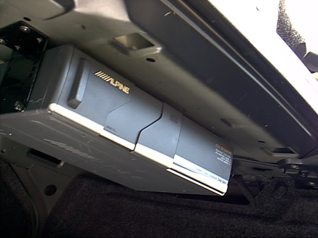

Here you go
Attached Thumbnails Can someone post a pic of their CD changer's installation position?-picture-013.jpg   Can someone post a pic of their CD changer's installation position?-picture-014.jpg

We have different stereos. All I had to do was plug it in and it was ready to go. Good luck with it.

On the C43 it was mounted on the right side in the pouch thingy. On my C36 I mounted it in the left and covered it with the trunk mat. Really easy install, just plugs right in.
