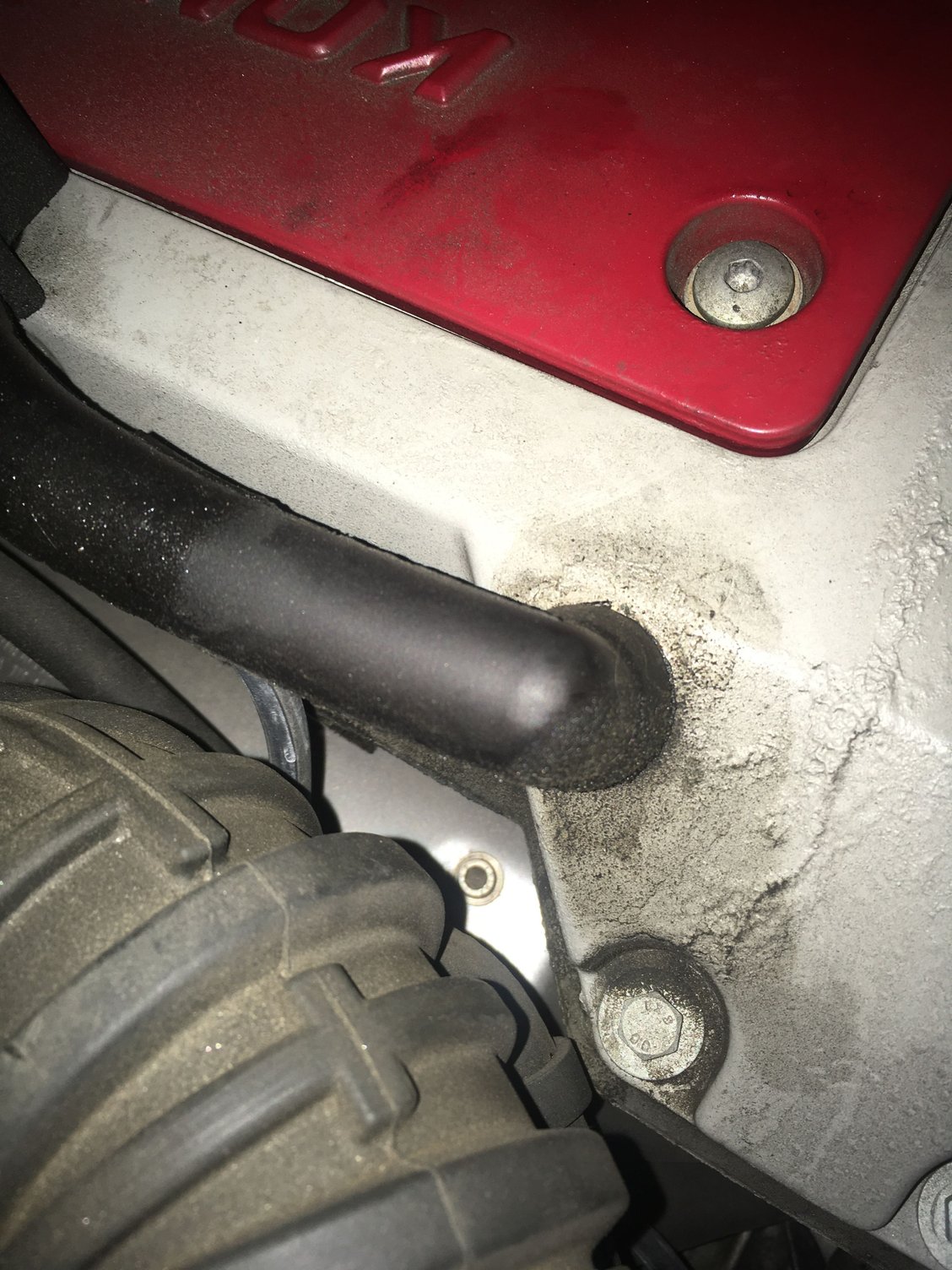

Just noticed that my oil separator looks very oily.
I don't really know what it does or the symptom of a bad oil separator. The engine has a very rough idle but I know one of the motor mounts needs change. Can a bad oil separator contribute to the rough idle also?

Sound like you might have a clogged PCV check valve. It's located on the bottom of the intake manifold. It's supposedly a PITA to get to because you need to both the intake and exhaust to get to it. Here's a few threads about it. You can find quite a few if you search for it:

I guess these parts are interconnected somehow. But why not just a failed oil separator?

The oil separator rarely clogs. Usually it's the PCV check valve. MB, like most cars, uses two types of crankcase ventilation: full-throttle and part-throttle/idle. Your photos show the former. At full throttle, the vacuum in the intake manifold pretty much much equals that just past the air filter. Since there's not a lot of vacuum the tubes to get rid of blow-by gasses are larger so pressure doesn't build up in the crankcase. The part-throttle to idle parts consists of a connection between the intake manifold and crankcase that sucks blow-by gasses directly into the intake manifold. It uses a precisely-sized restricting hole that is programmed into the ECU. This vacuum in the intake manifold is more than enough to suck out blow-by gasses at idle and the engineers took advantage of this: the full-throttle parts now work in reverse, and let fresh filtered-air into the crankcase to help keep your oil clean.
Things get a little different when a supercharger is added. When the supercharger is on the intake manifold no longer has a vacuum in it; it's pressurized. That means that without a check valve (which the C230K has) this pressurized air is going to be blown into crankcase, and the oil separator. That's most likely why your seeing the oil stains on the engine. You can also look inside your intercooler. If the check valve has failed, there will be oil there. It's really a check valve, not a PCV valve, even though it's called a PCV check valve at auto-part stores. It shouldn't cost more than $25.
Do the simple tests and checks first.
Check for the following and report back.
1) Oil contamination in the air filter housing, at the bottom end (lowest point inside and the filter itself.
2) Open up the MAF on the intake side of the hose that connects to the MAF - check for oil film contamination.
Oil contamination in the MAF intake hose can affect the performance and Kompressor.
If your oil separator isn't functioning correctly, any of the oil fumes will go into the air filter housing rather than thru the hose back into the crankcase to be re-purposed (for emission control purposes.
Replace it, and its hoses - they get brittle over heat and time. Optionally, if your State permits it, you can bypass the hose that goes into the air filter and vent it into the atmosphere. (plug up the intake connection on the AF box where the oil separator hose attaches into the AF box.

The oil separator rarely clogs..... .
They DONT CLOG UP per se, they malfunction and when they do malfunction, they don't circulate the oil fumes correctly into the correct hose line (back into the crankcase). Instead they vent the oil fumes/film in the AF box where it collects in the form of an oil film and oil. From there, it goes thru the Kompressor and circulates to the MAF. Not fresh air, but oil contaminated air.
An oil film builds up within the intake hose and contaminates the MAF sensors giving your mis-read air readings (due to oil contamination) leading to sluggish performance, acceleration, sputtering etc.

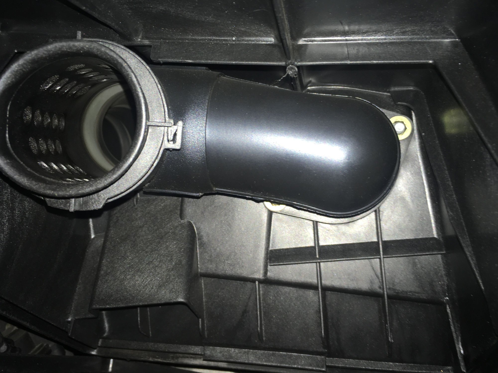

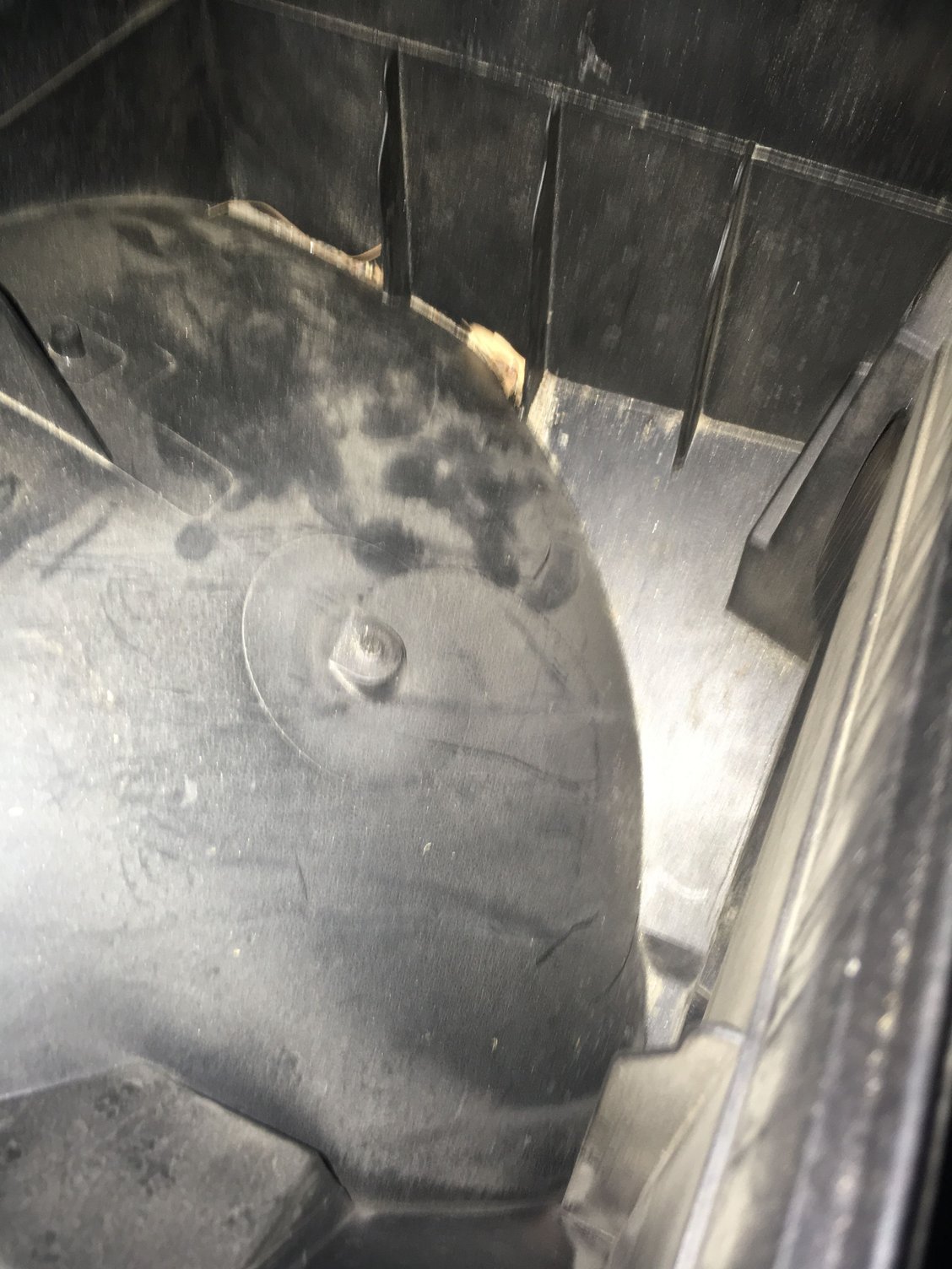

The air filter and the box are bone dry. Checked the underside of the upper box too.
Not sure which the MAF intake hose is but I checked the hose connected to MAF from underneath and it's bone dry once again. I ran my finger inside the hose and didn't feel any oil at all.
