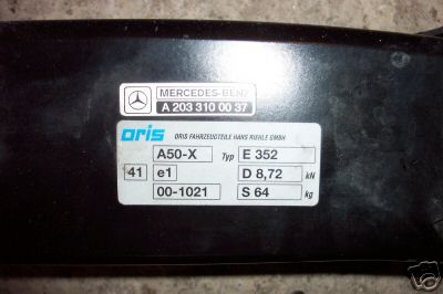

abnehmbare Anhängerkupplung für C Klasse Sportcoupe
When / if you go to MBWerks, talk to Randall.
Let him know I sent you.
In the meantime, I found this on the German eBay site:
Pics below:
Carlos
Saprissa@aol.com
Attached Thumbnails C-Class towing-tow-hitch.jpg   C-Class towing-tow-a203-310-00-37.jpg

Nice surfing saprissa, the holy grail of coupe hicthes exists.

On a hunch I Googled ORIS (from Saprissa's posted e-bay picture) and came up with http://www.oris-gmbh.de/english/.
As we suspected, NO hatch could survive in the euro market without SOME way to tow.
ORS claims to make OEM stuff for all the german makes. Could they be the company that makes the roof rack? I sent a request for more info, we'll see what the response is. Interestingly enough, ORIS has just opened a new manufacturing site in (where else?) Alabama. Maybe we'll have a full NAFTA hitch for the Coupe soon...
