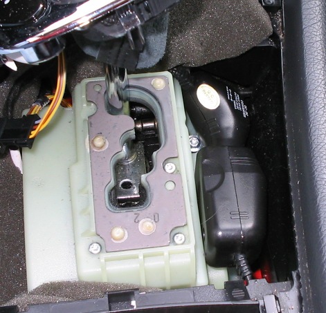

Here is the picture that I promised. I cut the end off of a power adapter and tapped into the cigarette lighter power line. The wires run underneath to the bottom of the lighter. As you can see the XM plug is still there and once the console is together you see nothing.

How do I get to the bottom of the power outlet to figure out which wires go where? I managed to pop the trim around the shifter. I can't get that off though. It's kind of in the way. what can i do?
You need to pop the shifter plate from the console trim and remove the console trim to get it out of the way. You will also need to remove your cupholder so you can release the lighter assembly and pull it back toward you. I have attached the pic again with the part circled that will release the lighter. Lift up on these tabs on both sides and gently pull toward you. This will expose the bottom of the lighter so you can tap in for power.
