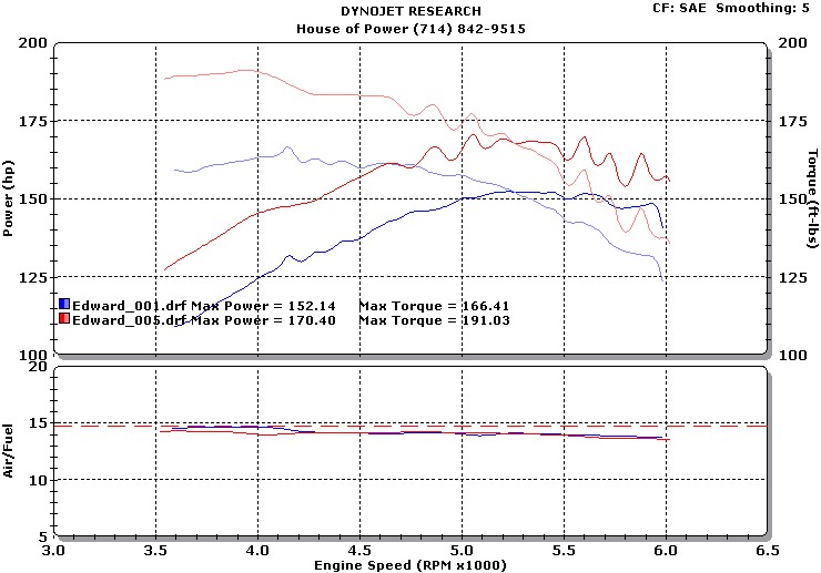

Results so far
Okay, yes, I got it done. Yes, I have been acting like an absolute idiot on the 405 tonight. I promise to be better tomorrow. Really I will.
You can feel the differance. The car will pull, cleaner, and rev faster. It is quite a bit fun. HOWEVER, this is not a end all end all. I have alot of work to do on the car. I'm going to give you the increase numbers, and later in the weekend, I will get the video, and pics up. Best part of the install, was my girl dancing in front of the huge cooling fan during a pull .
I gained at the wheel SAE
18.X horse
14.x torque
total numbers at the wheel SAE
170 Horse
191 Torque
This is not without problems however. After the pulley install, during the dynos, you could see how the A/F was leaning, and the timing was cutting back. Buell, I know you have the experience to back up what you were saying about the engine. But mine was leaning out. I should mention that the K&N filter I ordered was not in stock, so that part has not been done. I thought this was an Octane issue so I got a bottle of LUCAS octane boost. So I made quite a few runs. This worked a bit, but after about 20 minutes of hard running, I find that the car is not powering up. I'm not sure of what is happening. But turning off the car and restaring quickly does nothing. HOwever, letting the car sit for 30 minutes brings back the power for another hard session of 20 minutes.
It was suggested that the power be unplugged. Hmmm. I don't konw that we unplugged the power. Before the meet tomorrow, I will unplug the power and reconnect as was mentioned.
Give me until Monday to put the video and dyno chart up.
Yes, when the car is going, it feels good. Cool bit of kick in the pants. Definite differance. According to Josh at HOP it could be possible to bring out 200 RWHP with headers and an exhaust. But I don't understand why my engine starts retarding the timing. Any ideas?
Ed
<---after my girl being patient with all of the install stuff and my bonzai runs & the meet and greet tomorrow, I'm banned from the board till Monday.

Sure it leans out, but it shouldn't be that bad, maybe 12.5:1 and it's only for a second. Your HP numbers look really low, could be the dyno you were on need calibration, I never got that low. Which pulley did you do, the add on ring or the aluminum pulley? Also, octane didn't make much of a difference, ran a dyno with 100 octane unleaded racing fuel, waste of money, zero gain.

100 octane didn't do anything because you don't have the ECU remap telling the car that the fuel can be different.
higher octane definitely helps in making more HP. Went to a open dyno run and 1 Supra ran 811rwhp with 100 octane mix and ran 7xx before he mixed it.
also, different dyno often yield different numbers.

100 octane would have helped for sure if there was any traces of pinging. If the car was pulling back timing because of the knock sensor, which it wasn't, 100 octane would have helped which it didn't. Back in the good old days of the 2002 c-coupe I tried everything and anything and backed it up on the dyno. Heck, even knocked off the muffler to see what that would do....

Chart
Here is my dyno numbers
Buell, what mods did you have, just the pulley at the time? I have the whole aluminum pulley, not just the ring. I did a quick run to the grocery store this morning. Was running good. Now, to compare, I guess this is the best way I can say it. Feels like a Intake, Header and Exhaust add all at once. I used to have an 93 Integra that I did those adds to. I do like the increase supercharger whine.
So, after I disconnect the batter, and wait, isnt' their a restart procedure. Turn the wheel to the left all the way, then the right, then left again?

Spoke with Brandon at Kleeman. Great guy. He took the time to look at the dyno graph and do some thinking on why I'm down on power. Basically this likely comes down the an airmass sensor that is not right. The car is quite lean at higher RPMs.
From other dynos he has seen, people get somewhere around 200 horse, and 220 torque with that pulley. SOOOO back to the dealer to get that worked out. Once I get the car back, If I feel a differance I'll dyno again.
Ed

Like I mentioned on the phone, baseline run looks lean as does the pulley run. I think you have a bad air mass sensor. Have your dealer check out the "actual values" of the MAF when attached to Star Diagnosis. Any drop outs of calculated air mass (example: going from 200 kg to 300 kg while smoothly raising revs) etc indicates a bad MAF.
Attached is a dyno from a 1.8 liter car, although this is not your engine, the bottom fuel line is what any MB should look like (we use lambda rather than air/fuel ratio). Note the drop in lambda from 3700 RPM and up:
Kind Regards-
