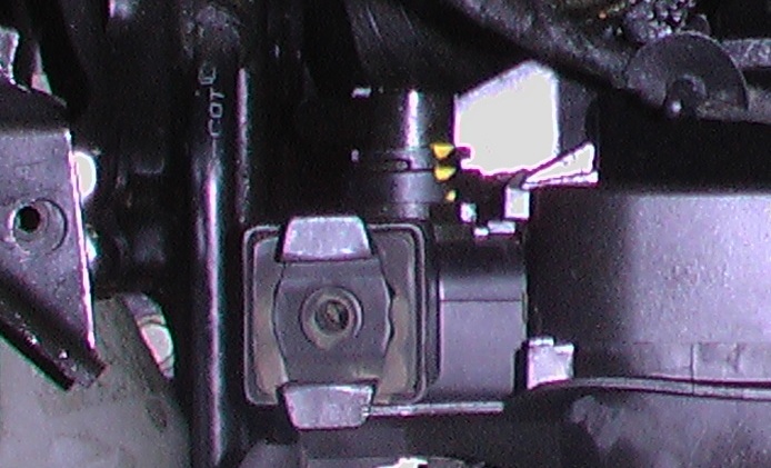

This is what I need help in figuring out the removal.
This is the mount for the line that connects to the tranny cooler. It had some type of U shaped pin that I removed. Now there is a collar that has a bit of yellow paint on it. Now, that the color is loose, how does it come free?
Thanks in advance.

From that picture it looks like it is bottom of the rad ? right ?
It is hard to tell without larger picture but if there was no hose clamp,
then it is just a quick release clamp you are talking about and hose should just be pulled out once clamp is removed.

Actually the pic was the top of the radiator looking down.
Hmm, it is looking like the connector for that radiator line requires a specialty tool for removal. I have checked quite a few websites for info on how to Remove the line, or what tool I need, but no luck.
So, I figured that I can put a piece of solid pipe in line to fill in the section with the hole. Complete the flush myself. Then take the car into a dealer to have the line replaced. Mikey mouse as all hell, but it will keep me from damaging the connection at the transmission cooler.
Hm weird I have never done such repair but I really doubt that it requires special tool to remove this hose. But I could be wrong.
It is not a high pressure line for sure those usually have bolt screwed in to the rad.
So you should be ok.
Or it does not come out because of rubber seal at the end
