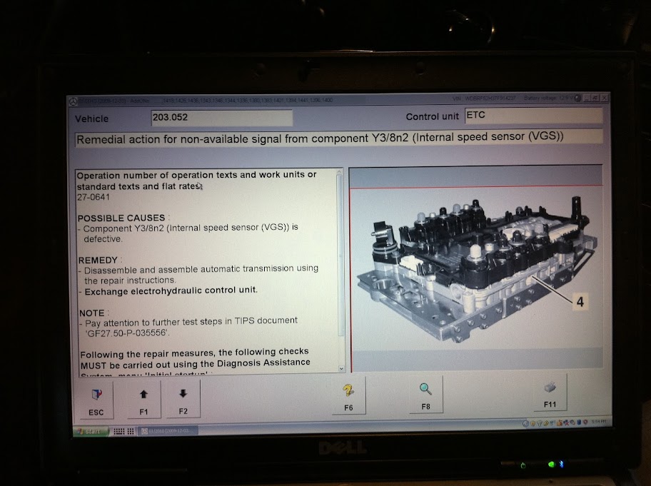

Drove home yesterday the 36 miles, and the car shifted like butter, as usual, and had no weird noises or smells.
Plugged in STAR and got code 2767: The signal from component Y3/8n2 (Internal speed sensor (VGS)) is not available. Remedy: Replace Electrohydraulic control unit. Are you F-in kidding me?!?!?! Replace the whole valve body assembly for a $1 hall sensor! Good old MB German engineering.
Not sure what I am going to do at this point. Local dealer wants $2200 to fix
