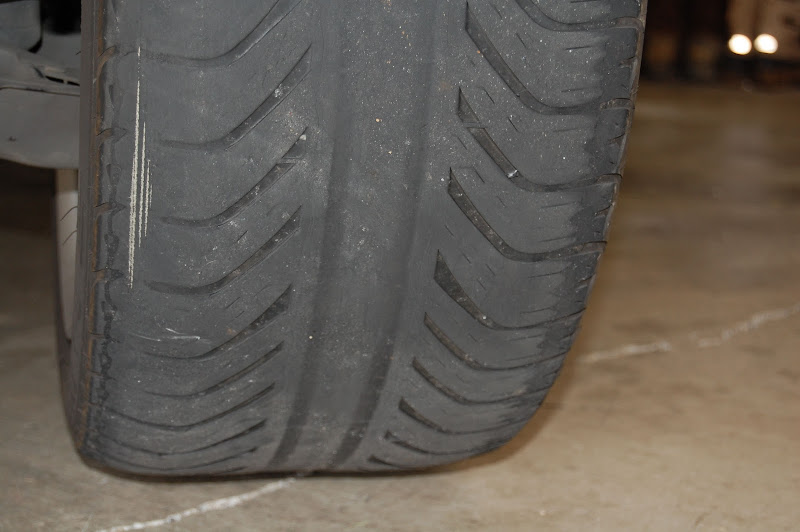

Old Jul 18, 2010 | 10:06 AM

Old Jul 18, 2010 | 10:09 AM

Wow.. that's getting your money's worth. What kind of tire did that used to be?

2007 C230SS; 2014 ML350 BT
That was the Michelin Pilot Sport A/S Plus. I have almost 33K on those. By far the longest lasting tires I have had on there. That is the right rear. The left year is still good, no belts showing. My tire shop called me last week and said the Continental DWS's were finally in. How's that for timing

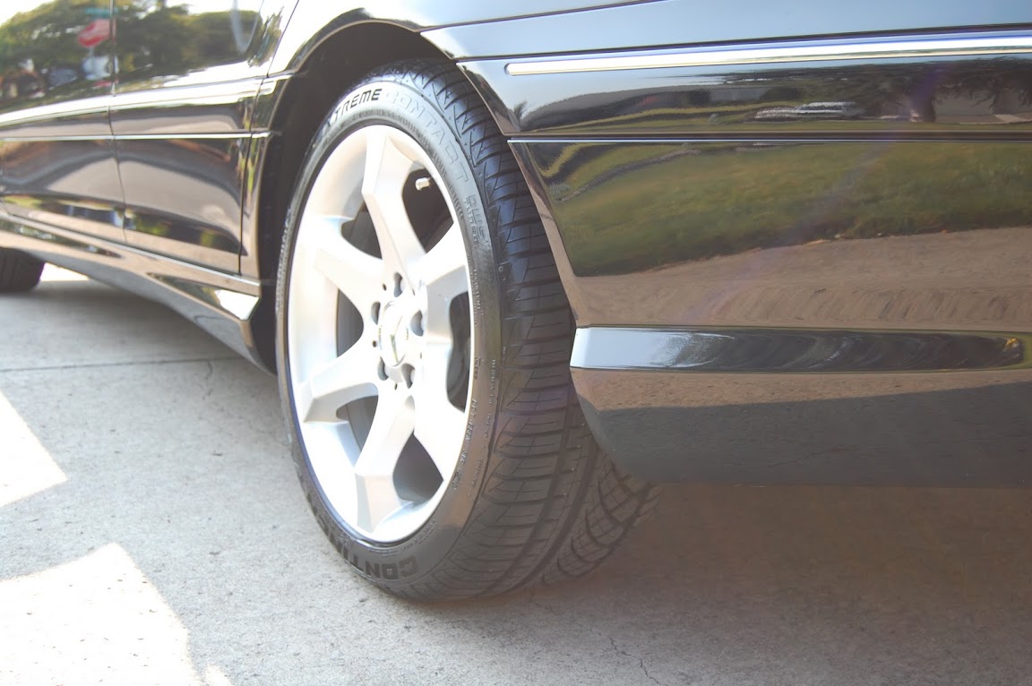

Old Aug 2, 2010 | 11:20 AM
  #195
johnand's Avatar
Super Moderator
Joined: Dec 2006
Posts: 2,403
Likes: 64
From: Camas, WA
I've had the new rear tires installed for about a week now. Here are a few pics:
So far I am happy with the tires. Here are some observations/comparisons of the new Continental Extreme Contact DWS's vs. the old Michelin Pilot Sport A/S Pluses:
The Conti's are always criticized for the soft sidewall, but they have a stiffer sidewall than the Michelin's they replaced. The Conti's are overall a tad quieter than the Michelin's. So far I have only driven the new tire on dry roads, and I would have to give the Michelin's a slight edge over the Conti's, but they both have very good dry handling. The Conti's felt a little loose for the 1st few hundred miles until the mold release agent wore off as expected. I feel I got a little bit raped on the price, as I paid $399 out the door. Matt scored a much better price on his. Though, they are still cheaper than the Michelin's.
Old Aug 2, 2010 | 12:40 PM

Look good! Yes - there is a certain amount of misinformation around regarding Conti sidewalls. I don't think anything has softer sidewalls than Michelin in general
Agreed. Michelin is the king of soft sidewalls in my experience. The Michelin's I had were 1 ply polyester sidewall. The Conti's are 2 ply polyester.
