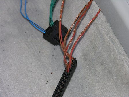

Yes I have opened the passenfger side of the car up and I have connected the CAM Bus bronw/Red wires to the appropriate connector in the sill. I also connected the D2B wakeup, 2 blue wires to the appropriate connector in that area also. See the pics I uploaded.Originally Posted by JohnCL
Did you go over to the passenger side footwell to connect the canbus wires? With the actual COMAND harness, not the adapter you need to remove the passenger kick panel and carpet to install correctly. You probably have the right stuff but just don't have it connected correctly.You will have two blue wires and one brown wire with a connector that need to go to the passenger side.

The ONLY thing that you need the dealer for is the dash display. The steering wheel buttons will work without any programming. Double check all of your connections again. On the canbus conntector did you remove the clip to insert the plug into the block? I know of a member that had an issue with the connector appearing to be inserted but it actually wasn't. Double check the long thin connector with the brown wires and make sure you are good. I recommend removing the locking clip and inserting the wires and replacing in reverse. Also, make sure that the C2 connector at the COMAND in in properly as that can be an issue as well. That would cause the buttons not to work and many other issues.

You mention the locking clip, are you speaking of the locking clip on the car's CAN B connector block? I removed that everytime I inserted the two pin connector. Reversing the connector does not allow insertion into the block, but I will do is inspect the block and see if the instertion of the connector is doing anything to the pins in the connector block. It is strange the CD suddenly started working? That does mean the CAN Bus is communicating at some level with the COMAND unit right? I just cannot figure why the Steering wheel buttons and the ignition have no effect on the COMAND unit?
I think the first thing I will do is move the CAN B connector over to another port on the Connector block and see what the effect that has on the COMAND unit as the CD came on after the move one slot to the left of the other connectors.

I pulled it apart again, examined all the connectors, installed C2 before C1 this time and reinserted the CAN B plug again. Well the steering wheel can now see everything. The COMAND unit shuts off shortly after the key is removed. Now all that has to happen tomorrow is for it not to shutoff 30 minutes into my commute after asking me to turn on the ignition or it will shut off in 3 minutes, while i am going down the road at over 65 mph!
