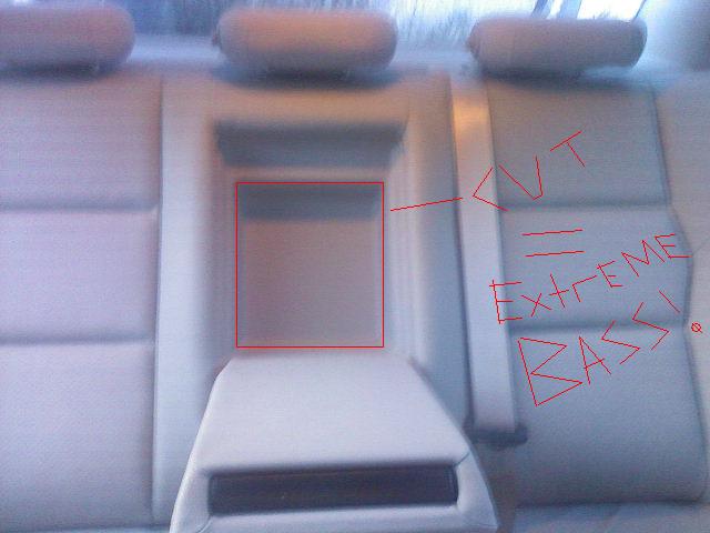

For my new subs I want to get more air flow into the cabin from the trunk. It will make it seem much louder to me if I was to cut the plastic out behind the middle armrest in the rear seat. Does anyone know if this is possible or if there is any electrical wires or like a metal plate of reinforcement behind it?
Sorry for the ghetto pic lolol

No need to cut it. You can just remove it. What you need to do is remove the entire seat, remove the carpeting from the back of it and you will see 4 screws that hold the plastic piece in.

Awesome do you know of any links showing how to remove the rear seat? That saved me some time and money

I posted a pic somewhere on here, but I can find it for the life of me.
You need to remove the lower portion first.
* there are 4 nuts that hold it in place
Once that is out of the way you will need to remove all the nuts and bolts that hold the back rest in place.
Once they are all removed you will have to go into the trunk and remove two plastic covers near the top of the trunk. This will expose a spring mechanism. Insert a screwdriver and move the latch. Then go back in the car and pull the seat out.

Alright that explains it great only other question is where are the 4 bottom nuts located?

If you look at where the seat meets the carpet you will see 4 plastic covers. Pry them off and you will find the nuts.

If I remember correctly- there's also some sort of small tube on the drivers side of the seatback that needs to be disconnected. It almost looks like an airline- but I have no idea what it is or where it goes. I had to give it an attitude adjustment with a little flat screw driver to get it to come apart. All is well now though.
Good tip on taking the cover off rather than cutting it. I am in the process of getting the car back together and I have been planning on making the pass through functional- just hadn't decided how just yet.
