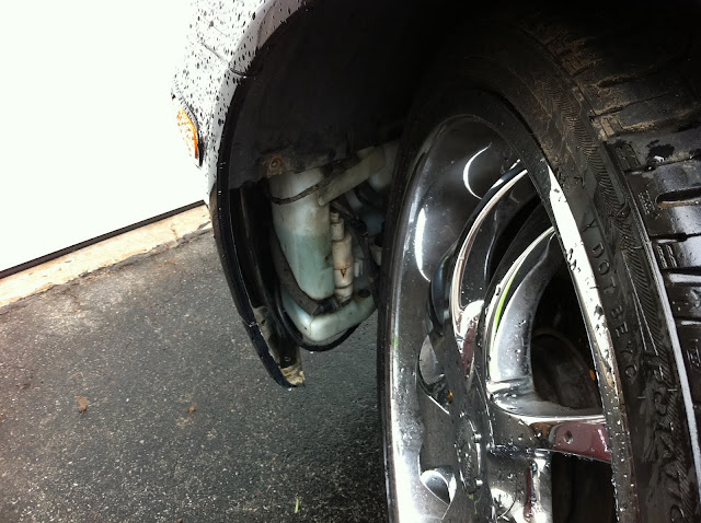

Got around to checking it out. It is really easy to get to and lives right next to the windshield washer pump. It is a $70 item and seems to be prone to failure. Here is a couple pics of mine. It is pretty obvious that the large crack with rust coming out of it is most likely why mine do not work.

I changed out my bad pump today. Works great and now I have my own personal car wash!
It was very easy to do by removing the plastic cover in the forward of the opening for the left or drivers side wheel. 3 bolts & some push plugs to remove the cover. The pump just slides up & out. Replace in reverse order.

It is the black rubber seal between the tank and the pump so it doesn't leak. It is better to have a fresh one when you replace the pump. Just ask for it at the dealer if you go that route. I believe I paid $72 for it. This is a simple fix so no worries. I din't even remove the wheel, just turned it all the way right after I removed the 3 or so bolts that secure the plastic cover. See my pics in this thread for an idea of what to look for. Look at the pic where the pump is mounted... see at the bottom of the white pump there is a black rubber grommet... thats the one. It's not the one on the hose, but right at the plastic tank.
EDIT: It is a little hard to see from that angle.
#60 is the pump and #70 is the grommet...
