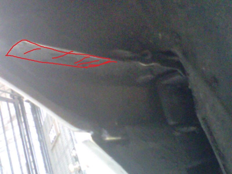

I spent a couple days heating up my fender and pushing out that tab smore, then took the dremel to the tab. I made only a few mm of space, but I am no longer rubbing. Actually, scratch that i rub a teeny tiny bit when I have a full load.
Thanks for the help everyone :P
Lowered the front a quarter inch too. No pix, just happy to be mostly rub free! 235/265 + more camber has proven to be completely awesome while pushing the car hard around turns. Cant wait for the PNW to dry up s'more so I can drive hard more.

I took a dremel and shaved down my tabs too... i'll try to take a pic to show you how much. its pretty close like yours, but it helped a lot in the end.
Im sure anyone who's grinded down there knows what im talking about. I feel like a damn dremel pro now after grinding away in there. hahah!
****ty pic in chinatown:
Good rake and even space between fender/tires all around, but after creating an account on stanceworks, all i wanna do is go lower + space out and run skinny tires. hahah!

I need to do my rear tabs still Do you have any good pics of your work so I can get an idea what needs to be shaved down?
Ya know, while I was down there, i told myself to take pictures, but i didnt cuz i just wanted to get that **** done and be done w/ rubbing I swear, i fyou poke your head down there, you'll KNOW the first time you look at it. The huge tab/bracket that you have to take down is readily apparent. The one thing I was concerned about was cutting off too much of the bracket and the bumper/fender not staying together, but after talking w/ Phister, I knew i had plenty of space to cut away. Phister cut all the way to the screw... I have about half an inch till I get to it, but i didnt need THAT much space.

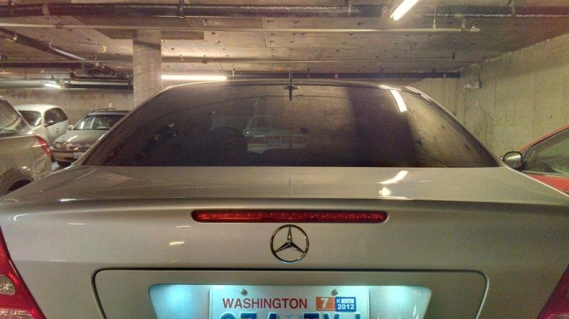

I finally installed the 05+ brake light as mine was cracked but didn't want to die. I also Installed LED Plate Lights from AZNOptics!
Whats the diff between the pre/post facelift tail lights aside from the entire bottom being lit? Are the new ones actually lighter in color or brighter?

There is a big difference in how the facelift taillights look at night. The entire bottom is lit up as you already know, but it's the reflectors inside on the facelift vs the diffuser on the lens of the pre-facelift. Like frosty headlights the diffuser-type taillights just look 80s.
Here are pics:
vs

You can fit the 2 extra lamps to the pre facelift housings if it bugs you.

Glyn - do you have pictures of someone who has made their prefacelift tails light up like the facelifted ones?
