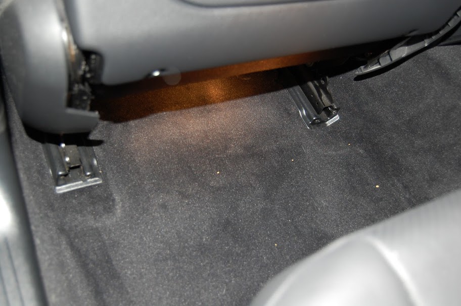

my c320 is having a really wired problem. the power seat worked perfect when i got out of the car to go to class. then when i came back i closed the door put the key in the ignition and the seat didn’t move forwards. i played with the switch and heard a clicks from under the seat. it could do everything but forwards and back. i drove half way home and hit the memory button and the seat went to its proper position. i then went forward and back all the way and it seemed fine. i then parked the car and went forward and back again but now it wont move again. any ideas. i do have new seat modules (i think that is what they are called) they have 07 on them so i don’t think that is the problem. and the switch seems to work because i hear a click from the module. any ideas my best guess is the motors but searched on here and found only one person who had a bad motor. so i have no idea hope somebody has seen this before.
ok well just got in car again for a quick run to the store and the seat started working but i think needed to be synced so i ran it all the way back and heard a hoirble noise and i think it started to come off the tracks so i slowley got it back on but found two little pices that had come off below is a pic.

so i fixed this a long time ago and got a pm about someone else with this problem. they are the clips that tell the car that the seat is as far back as it can go. they are really easy to put back on. look at the other seat and just push them on just like the other side. then re sync your seat. hope this helps someone.

yeah i used it till it stopped working because those clips came out. then since the seat stopped moving i turned the wheel off too. so when i fixed it i tried it out, it worked and i tuned it back off. right around the time i fixed this i read a post about the motor for the wheel burned out or something and it was an expensive fix. i then decided that i am young and not tall enough to really need the seat and wheel to move every time i get out. i thought i might be the only one who actually turned off a convince feature lol.

Trey, any more info on this? Do they fall off completely? I had the easy exit feature for the seats enabled on my 07 by Sunil shortly after getting my car. (07's have easy exit for steering column only enabled, not seats). The other day, I noticed when I opened the door, my seat clicked, and noticed it was trying to move back but was at the end of travel. When I get in the car, and stick the key in the ignition, the seat moves forward, but only a little bit, not to the memory position. If I hit my memory button, it then moves to the correct spot. I tried resetting position by moving the seat all the way forward and holding that position for 10 seconds, but that didn't work. It still acts like it doesn't know it's correct position, and hits end of travel before getting to the rearmost position.
interesting mine actually did fall off completely on both tracks. which then caused the seat to try to go off track. i wonder if only one is missing or something and that is why it acts funny . i would get a flashlight and look to see if both are on there if not and you don't see it you could steal one from the passenger until you can get another one.

Matt, I bet that is the case. I know for a fact that MB was trying desperately to improve their quality in the late 2000's. That included removing and disabling features.
btw also good job searching this is an old thread
Trey, thanks for the info. I'll crawl under there this weekend with a flashlight and see if I can find anything loose or missing. I wonder if my passenger side has those seats, as the forward and back is not powered like the driver's side.
ok well look for the clips the pic i posted at the top are two of them. dam too bad your passenger seat is manual oh well let me know what you find.

Ok, I looked everywhere under my seat for those clips and I don't see them anywhere. Maybe they changed the late 203 seats? So, I did a little more investigating and found that my driver's power seat only has 2 1/4" of total travel front to back. The non-power passenger seat has 8" of total travel. When the seat hits the forward position, it hits very softly. When it hits the back, it clunks loud, and the lights dim, like it is hitting the over-current limit. Here is a pic of the position of the seat tracks in the full back position. I swear it used to move back further, and I can see wear marks in the track like it did. Is this the correct track position for full back?

that looks different then my tracks so i guess they changed it. GL i have no clue

I gotta hand it to you Trey, this thread helped me out last weekend! I think that's when it was! Either way, my passenger seat wasn't going all the way back, and it's never done that before. Also, while moving it forward, it made a funny clunk noise. Needless to say, I came across this thread which helped me identify, locate, and fix my problem! One of the two pieces you show in your first thread was not on the track, it was uctually loose on the track and was moving around as the seat was moving forward and backward. Anyhow, next time I'm in McLean there, I'll have to hit you up and get you a beer or something! I got family in McLean, so I sorta know the area!

Originally Posted by PA_Pete
I gotta hand it to you Trey, this thread helped me out last weekend! I think that's when it was! Either way, my passenger seat wasn't going all the way back, and it's never done that before. Also, while moving it forward, it made a funny clunk noise. Needless to say, I came across this thread which helped me identify, locate, and fix my problem! One of the two pieces you show in your first thread was not on the track, it was actually loose on the track and was moving around as the seat was moving forward and backward. Anyhow, next time I'm in McLean there, I'll have to hit you up and get you a beer or something! I got family in McLean, so I sorta know the area!
Glad to help when this happened i searched forever and never found any info on the dam seat tracks. so i gave up then finally went back and figured it out. I am glad to give back to the forms who have helped me a lot yeah next time you are in McLean let me know maybe we could do a small meet or something.
