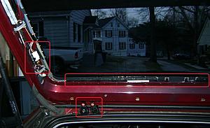

My coupe started out with poor Lock/Unlock and IR door handle reception.
It used to work maybe 50% of the time then eventually 0.
I use the physical key now all the time.
I have 2 keys, the old black style and the new chrome. MB of Devon looked at this a year ago and said to start diagnosing it with a new key first. When that didn't help they suggested a $500 module in the steering column that might fix it. I declined cause it really doesn't bother me that much.
I was outside earlier checking the hatch and I'm not sure what I should be pressing on to see if there is contact with the metal grid in the window.
Windows are tinted but this started way before then. AM/FM radio reception is fine. I have replaced the batteries in the keys multiple times.
Has anyone actually fixed the radio receiver problem: U have to be 2" away to lock/u-dsc01400.jpg
You can see my 2 keys sitting there. The antenna amplifier in my car is w 203 870 23 89
Which parts should I look to replace?

Check sticky pad at the top center of the rear screen

Well I did find a solution to my recent loss of radio & key fob connection. I removed & checked all the fuses one by one that were related to the locking system (#8, #9, #21, #22, #32 and #33). I tried it after that and all is well with my Benz world again. It is working without issues for now anyways.

Hi All,
I'm having the same problem with my C240 sedan, both remotes dont work at all, even when pointed at drivers door IR receptacle. Even replaced with new batteries nothing works...cant lock/unlock/open boot.
I ordered an antenna amplifier 2038701389 online from UK but they sent me one bearing part no. 2038200989 [upon checking online, this is replaced by 2038701389] to my doorstep yesterday. It cost me a total of 84 sterling pounds which translates to USD150.
So this afternoon I will be making a trip to my installer to get it fitted and hope that my remote problems will be history! Will post what happens later so wish me all the luck in the world, thanks.

The amplifier has been redesigned many times. While they are working in the rear C pillar make them check earth & sticky pad at the top of the rear screen.

Glyn, thanks for the tips but what is the purpose of the sticky pad and how do I check it?
I opened the C-pillar and unplugged the existing amplifier and connected the new unit without sticking it into position then tried using the remotes but they still do not work. The earthing is fine, so too the glass heater elements and connecting wires [there were no cuts when they tinted the back screen]. Am at odds end now.....dunno what to do next. Can anyone offer some assistance in troubleshooting this?
