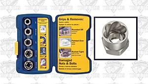

i found a pic of the tool i was looking at. its 20 bucks.
Those will work.
its too tight to use vice grips. im thinking of using a torque wrench.
Yes that tool should work. Buy the correct inverted torx socket to install the new one though.
buy it. I've seen it in action. they work quite well.

i fixed it already. i bought the tool and it worked pretty good but i had to use a torque wrench. replaced the bolts with some really hard *** kind of material from a local hardware shop. i just dipped the whole thing in loctite and let it dry. works pretty good. better than the original bolt.
