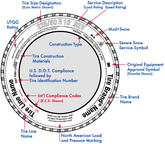

This might help if you don't know your tire size.
