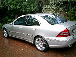

Originally posted by Lynn
You can't use the E55 wheels for the reasons Harris gave. The bolts are the wrong size and the wheels will fall off if you use them. The 12mm bolts won't fit in the 14mm hemispheric holes properly and they won't have enough clamping pressure to stay tight.
here they are on the C32. mhh's car on c32 forum.
Old Sep 1, 2003 | 04:10 AM
Guest0001
Guest
Posts: n/a
it looks allright
are those 18s?

Old Sep 1, 2003 | 10:10 AM
Lynn's Avatar
Joined: Nov 2001
Posts: 3,744
Frank, as Harris posted wheels in that style with the proper 12mm bolt holes can be piurchased. That is what is on the C32 in the picture. The actual E55 wheels should not be used for the reasons I posted.
of course...but I think when Humblepie said E55 wheel he meant the style IV for C-class. Not the actual 18x8 and 18x9 used on the E55/E-class.
