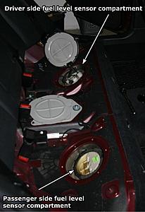

The fuel pressure regulator is built into the filter - so you have replaced that as well & it might have been part of the problem - see pdf. The pump is mounted in sensor 120. Access is via round cover plates under the rear seat. We don't need to touch anything. Let's monitor the situation. No unecessary expense!
https://mbworld.org/forums/attachmen...1&d=1279969411
Attached Thumbnails Down shift, check engine light, V8 grumble, power loss, and a burning smell. (20 sec)-fuel-pump-driver-20side-20locator.jpg
