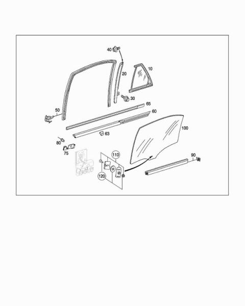

I doubt it is the actuator. Likely just the plastic attachment parts that hold the glass to the mechanism - cheap!

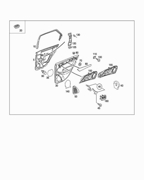

In other words, part 110? As of now, my door looks like my picture provided. Is it safe to remove the airbag? Every time I mess with airbags, I feel like I could get knocked out by a pillow at any moment!

Lane - Sorry - I could not see your picture this end - Let me find you back door - hold tight

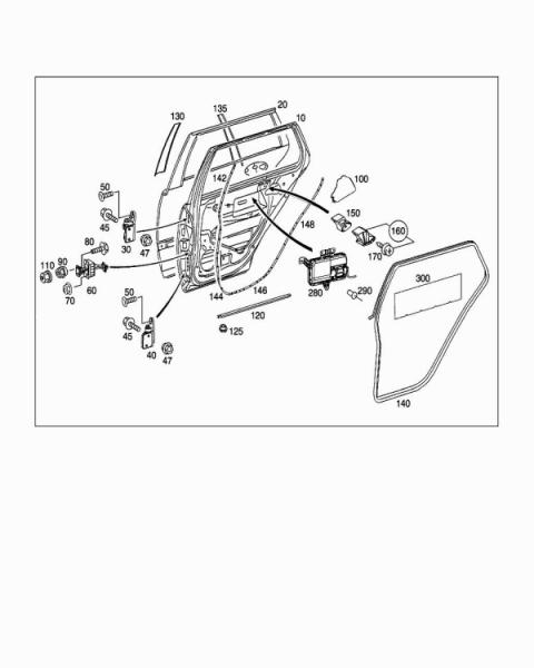

Old Jul 21, 2010 | 10:22 PM
Glyn M Ruck's Avatar
Super Moderator
Joined: Jun 2008
Posts: 19,942
Likes: 192
OK - here is the back door.
Door
Panelling
Regulator
Window
Door lock
See window diagram for attachments to glass.
Attached Thumbnails My window is gone.-rear-door.jpg   My window is gone.-panelling.jpg   My window is gone.-regulator.jpg   My window is gone.-window.jpg   My window is gone.-door-lock.jpg
