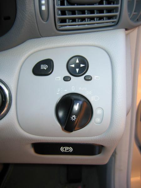

when you say pull the knob out, which knob would that be? the main headlight control knob?

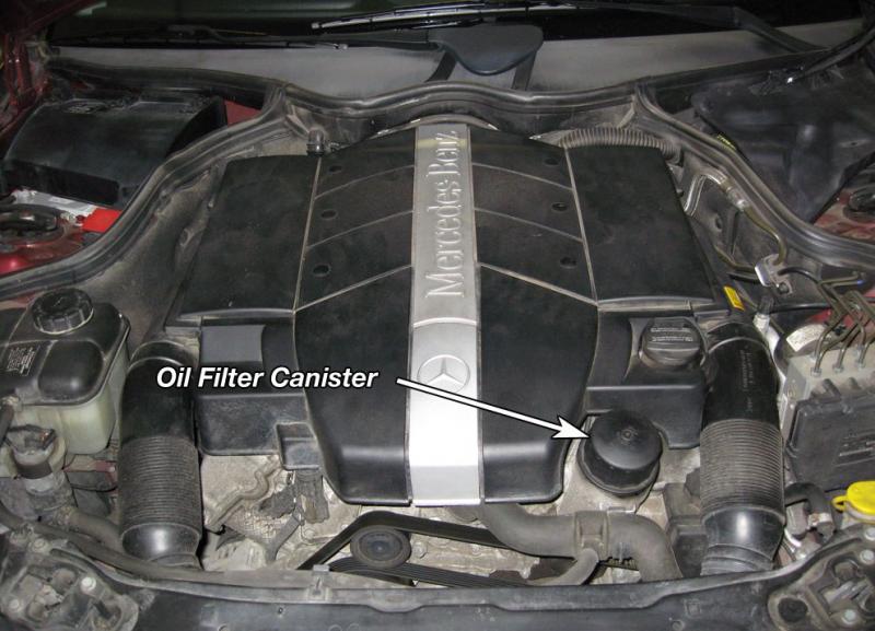

Also, is the oil filter underneath the car? I have car ramps, you metioned a socket, like a cup socket where a 3/8 rachet locks into? I'm assuming 7 quarts will cover the oil and filter change? Thanks

Sorry - 2.26 in the morning this end. You don't even have to pull the airbox with the older cover.

I thought that was the oil filter, I'll wait to hear about the lights

This knob - main light knob
Bigger filter shot
About 7.5 quarts will do it. Depends what you get out.

I see, you have to pull the knob out, than you select the option of turning on those lower street lights. Awesome photos and awesome answers. As far the dush bag commenting on my "stupid questions". No question is stupid and for those who think otherwise can't comprehend how people actually learn.

@glyn, you are like the new buellewinkle... I dunno how this forum would operate w/o you :P glad to have you around. Your pic of the light knob is backwards too
