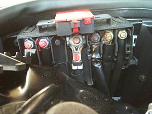

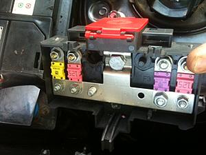

Looks like I have found the problem.
There is a fused distribution block near the battery. After pulling it apart I found that one of the cables has obviously had a poor connection and has slightly melted. This would explain why most of the fuses on the drivers side are showing 10.5v when the engine is running. I'm hoping this explains the poor voltage supply at the radio, the intermittent check engine light and ESP not available warning too. I'm off to Mercedes parts in the morning as I broke the fuse trying to get the crispy chicken cable undone. Also I have to put a new terminal on the cable. (I hope there's enough slack) Pics below.
Will let you know the outcome tomorrow!!

Sorry should have mentioned: With engine running Battery 13.6v, fuse panel in boot 13.6v, fuse panel drivers side in the engine bay 10.5v. And from what I can see I'm thinking this cable runs to the drivers side from this fuse block.
Only problem is Mercedes only have 1 of the 200A fuses in the country and it's in Western Australia. (Nice work Mercedes)

No fuse - Yugh!! Regulator should cut in at just over 14 volts.

THAT WAS IT!!!!!!
Radio issue GONE! No ESP available issue GONE! Check engine light GONE!
That could have cost THOUSANDS if I'd sent it to Mercedes!

Great news! - Almost looks as though some battery acid was spilt on those connectors.
