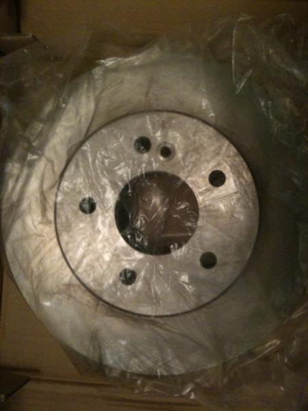

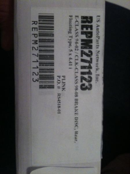

Hey guys
I purchased rear brake discs for my car back in April.
The website (Car Parts Wholesale) had them listed for my C230 Kompressor 2005 with Sport Package.
Now, that I am Finally bringing it in to get the brake job, I am thinking that they are not the right ones.
The box says E Class 94 to 02 and CLK Class 98 to 08
Floating type, 5X4.41 i
NOT C Class 2005 lol
Anybody know anything about this?
Btw, I got a quote from a local place called Brake World for $210 to install them with new pads. Does that sound reasonable? I know the dealer wanted $480 for rotors/pads and installation. All I wanted to do was save some money
Thanks guys

That appears to be part #210-423-10-12, which is the rear rotor for the CLK350 Sport AND the C230K Sport 2005-2007. It's only important to compare part numbers since a lot of parts are used across different models. That's the right part you have from what I can tell. Remember the 209 and 203 are VERY similar mechanically.

They wound up being the right rear rotors!
