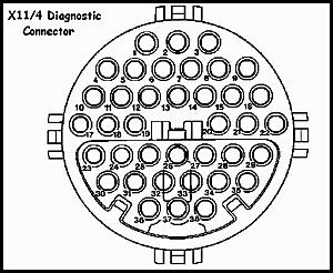

Old Sep 20, 2011 | 07:52 PM
Glyn M Ruck's Avatar
Super Moderator
Joined: Jun 2008
Posts: 19,942
Likes: 192
There should not be a 38 pin socket.
Old Sep 20, 2011 | 10:59 PM
glen5354's Avatar
Joined: Aug 2011
Posts: 6
c320
My apology, I meant 38 pins connection and not the 34 pins connection. Planning to order one of this tool http://www.cardiag.co.uk/si-reset-mb38-210.html to reset the red SRS warning light on my 2002 C320. Do not seem to find any 38 pins connection anyway except the OBS2 connection under the dash. The SRS lights came on after coupling collar installed. Thanks everybody and Glyn, VERY MUCH APPRECIATED for the help with the pictures you posted as to how to remove the ignition from the dashboard and finally got the job done. The steering column now moves up and down and in and out. The problem now is to clear the SRS light.
