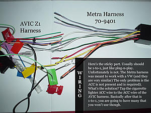

Thank you very much. So the metra "reverse adapter" I have selected is incorrect? Do I need this one? (photo from the giant audio thread)
It appears to have the speakers and the power/ground/acc swapped sides as compared to the other harness.
I have looked at the PAC website, it doesn't look too difficult to program the unit.
I hope the head unit can run the rear speakers and the sub ok. I would prefer not to have to run RCA's, power and power on through the car for an amp for the sub.

you're welcome. the one you have pictured is correct and the advice it gives for ACC is correct as well. do not run the factory sub off of the aftermarket head unit alone. if you want bass, you need to go the aftermarket route. do something small.
