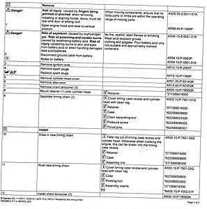

Originally Posted by Glyn M Ruck
Regarding a DIY chain/tensioner replacement on the M271 I4. I do not have it & there are a couple of special tools that make the job a lot easier to feed the new chain & hold the camshafts in the correct position so that you get the valve timing correct to the crankshaft.
Maybe someone could post the method from the maintenance CD or Star.
I have split the first image to help viewing !
Attached Thumbnails 2005 C230 Kompressor jumped time..HELP$$$-cam-chain-271-1.jpg   2005 C230 Kompressor jumped time..HELP$$$-cam-chain-271-2.jpg

JC - you are a star! Can't you post it as a pdf?
Johnand. You guys with the maintenance CD's & WIS that post pdf's. Do you need full Acrobat to do that?

You were right, Glyn, This is interesting. MB has a method to their perceived madness.

I will convert to pdf for everyone tonight. If you need IT assistance, just ask... It's my profession, and will do my part to help this forum and MB community.
File Type: pdf
Thank you. Can you add the final page to the pdf please

M271 Timing Chain WIS - Final
See attached...
