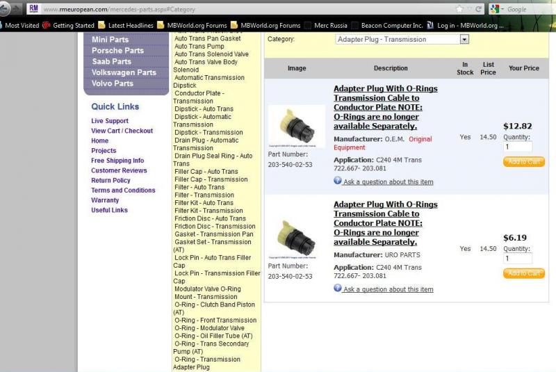

Old Feb 4, 2012 | 07:04 PM
  #37
Glyn M Ruck's Avatar
Super Moderator
Joined: Jun 2008
Posts: 19,942
Likes: 192
Yes - but that is a crap price. I paid $8 for my last genuine Merc one from RMeuropean. Let me check.
Old Feb 4, 2012 | 07:09 PM
  #38
Super Moderator
Joined: Jun 2008
Posts: 19,942
Likes: 192
Gone up a bit.
