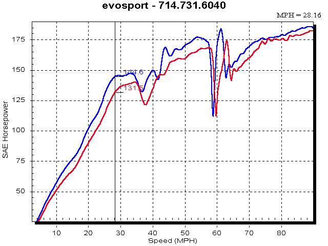

The pulleys should provide a 13hp increase no matter which motor is used if all the stock pulleys/accessories are the same.

Our pulleys work on all 1998+ V6/V8 (naturally aspirated) Mercedes motors. 13hp may be a bold claim, but we have many dyno's to back it up:
There are also several other dyno's of our pulleys on MBWorld posted by various owners.

Well those dyno results are pretty impressive. Thanks for the post. I really didnt expect such an increase in hp. Ill be giving you guys a call in few months as soon as my wallet recovers from the down payment.
