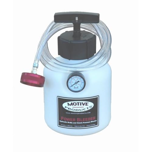

it wont hurt the master cylinder it'll just overflow the reservoir. What you can do is run the car and take the cap off the reservoir and pump the brakes and see if air bubble come up. but I would flush the brake system just to make sure there aren't any air in the lines.
I have this from amazon, works great for bleeding.
Amazon Amazon
http://www.amazon.com/gp/product/B00...ls_o03_s00_i00
thanks for your help phister! I'll try that and see if that solves my problem.
