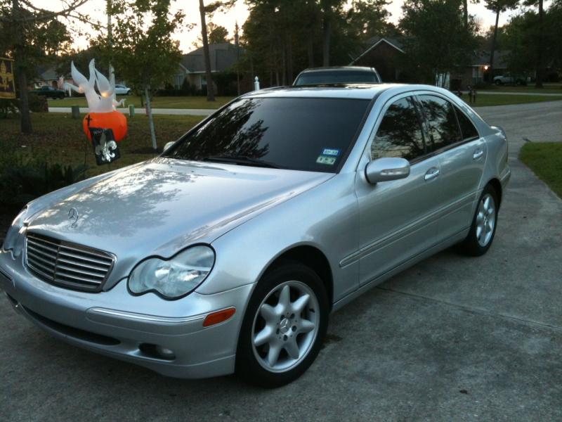

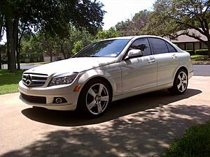

im looking to get some wheels for my 02 c320(non-sport) and really only interested in oem/replica wheels. i found a set of 18" e550 wheels on a w204 that look pretty good but im wondering how they would look on mine. can anyone help me out and photoshop the wheels on my car or another silver c320?
In the pic, my car my not have the right stance for the wheels of the other

Here you go. not the greatest photoshop job but you get the idea lol

In addition to the size issue, don't you think those wheels are a bit too straight-edged for the w203 body? I would suggest you get a set of 2005 17" sport wheels, and if you prefer the angular look, I think they sharpened them up for 2006.
