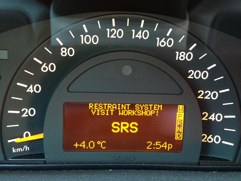

Hey guys,
So I turned on my car, wasn't in an accident and then it gave me this error message. Never seen it before and on the rest of the forums it seems that everyone else that had this message had either been in some level of an accident or if not a whole slew of other problems were occurring at the same time. Any one have an idea if this is a serious issue that needs to be fixed? I ran over some major potholes over the weekend, so could it be that I just loosened something up and that's what caused it?
Thanks in advance.
Cheers!

I had that warning and it turned out to be a broken wire in the door. Mercedes fixed it up and reset the warning, pretty cheap actually.
From what I have read here you are best to go get the code read and find out why it's there. Mercedes are the only ones that can clear the warning I think.
My theory was it's the saftey system (airbags, belts etc) so it is the one thing I would rather it get taken care of at the dealer. If my wife got into an accident and something didn't function the way it should due to a short cut I took, I'd be shattered.

Yup turned out to be the same thing, right rear door airbag. I have a local indy that ran the service department at a stealership for 20 years so he got it done right. Cost under $200 CAD, so not too bad I guess.

Same door for me too... How about that?
Glad it got sorted!

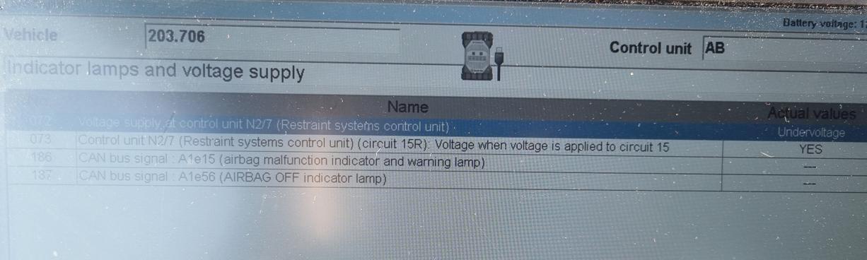

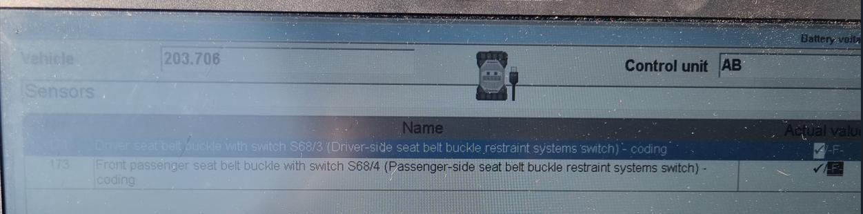

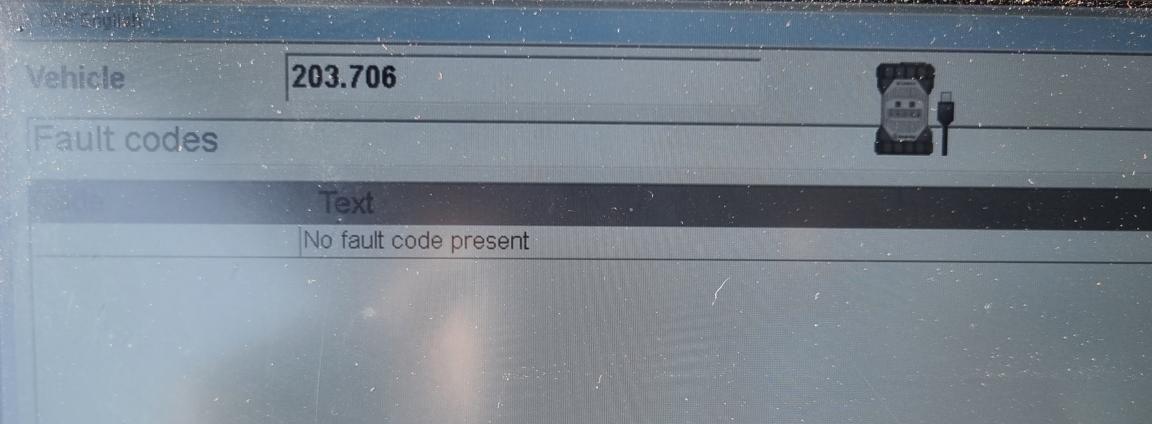

Hello
To get back to the topic, I'm having a problem with my 2001 Mercedes C220 Coupe: the SRS warning light is on. I have a "RESTRAINT SYSTEM VISIT WORKS" message. (WDB2037061A193769)
After searching the forum and using the C6, I think it's a communication issue with the N2/7 module. The diagnostic says "under voltage on voltage supply at control unit" but no error code is reported.
I just tested it and I do have 12V on pins 1 and 29 of the N2/7 airbag control unit.
Is the control unit defective? Is there anything else I should check?
thanks

it's a serious as you make it if you get in a wreck your airbags probably won't go off.. there is a service recall for this they will go in and replace your seat belt buckles and also an airbag I believe on the driver side door. If you reach up underneath your seat or look up under and find the wire that has the yellow end connectors they will be on the front of the seats up underneath if you can wiggle those and they move I suggest putting a small drop of super glue a very small drop just to hold them stable when they wiggle around or people move seats or aggressively get in and out of the seat it can jostle them around also throwing the SRS

​​​​​​ cost you $200?? That was a safety recall and it was 100% free... not sure why you had to pay 200 but I would have took my *** to the dealership and had them replace it for free LOL
