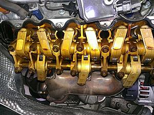

hear what sounds like a roller cam bearing. front of mator. what kink of job is it to replace, need to shim and and/or lashing it - re-cap'ing (like you do on a lifter?"

The M112 engine has zero lash hydraulic lifters. All you have to do is pull the respective rocker shaft & replace the rocker/roller assembly as long as the tappet surface on the lifter is not damaged. Rocker roller failure is very rare. These things are built like a good racing engine.
You might just have a sticky hydraulic lifter.

only after it warms-up, there is a tapping/clicking noise in front of the motor it is more center of the engine. as i mentioned, it sounds sorta like a rocker not lasehed properly in a older car that had rockers/lighters...
so i am taking it for granted, it is a cam bearing

Here's what it looks like
Attached Thumbnails roller cam bearing-395965_505480369476999_1593413155_n.jpg
