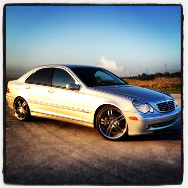

BTW for anyone curious, here is the C230 you are all helping with.
I know she is basic, but I'm a simple less is more guy....I even opted to trade out my AMG kit for the "Executive" kit I believe was it's name. Don't get me wrong the AMG kit is nice...but this kit had a subtle tone I liked more at the time.

so you have hub ring adapters to make the wheels fit our hub size right? it might be the issue but it sounds like bolts are cheaply made. Now when you install the lugs are you torqueing it down with a torque wrench to 80lbs or are you using a impact to remove and install the bolts. its ok to remove them with the impact and you can impact them down just a bit but you'll want to torque it to spec with a hand torque wrench to the proper torque.

Yes I have the rings to match my rim to my hub size correct. But when the rim is off and I put the ring on the hub and try to "shimmy" the ring...I can't feel any play between hub and ring, and as for the ring to the rim it takes a good push to get the rings into the rims so clearly no play there.
Always remove by hand, and install by hand....I don't even like using impact to remove. And I do use a torque wrench to 80ft/lbs yes.
For now I have ordered stronger bolts, should be here in 3 days I will post back in a week or so and give an update.
Also just because it couldn't hurt I emailed Zinetti and explained my problem and asked for new rings.
